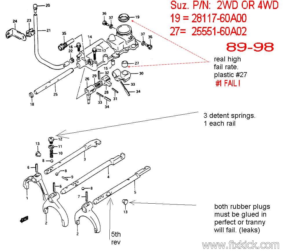

Not clutch slip,   not A/T slip, and not the shifter lever tip #27  bushing bad missing, or transfer case in neutral.
