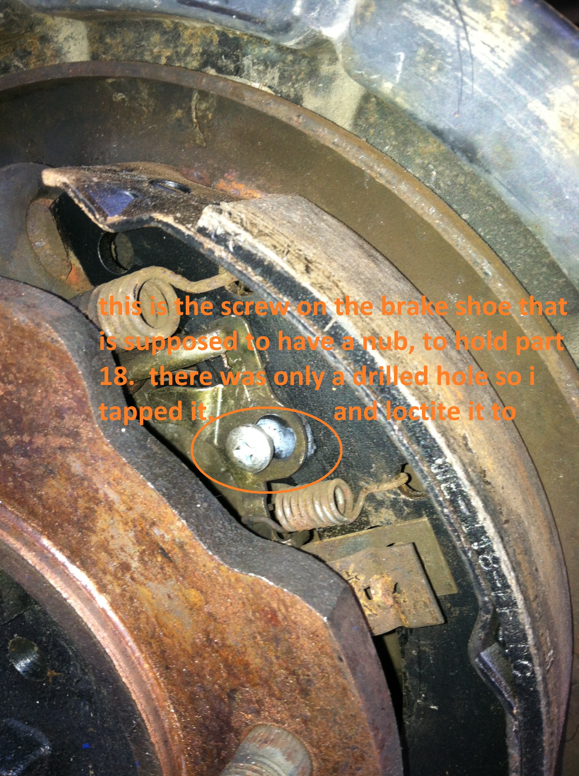

where is that loctite? exactly? in the rear shoes?
you dont want brakes to lock up, please be careful....

(07-06-2013, 01:40 AM)fixkick Wrote: where is that loctite? exactly? in the rear shoes? locktite is only
on the screw that I used to hang part 17, after I tapped a thread and let it cure. because the nub that it hangs on wasn't there. there was only a hole

part 17?
missing off shoe or backing plate?

(07-06-2013, 03:49 AM)fixkick Wrote: part 17?
Sorry it is part 18 it is the piece that moves the adjuster to tighten shoes as they wear. here is a pic of what i did. the nub was not there to hang that part on, there was only a hole in the brake shoe, so I drilled a larger hole and tapped it to fit that screw and locktited the screw in there. I had to do the same thing on the other side of the car too. the hole was eactly where the nub should have been pressed in, or welded in.
