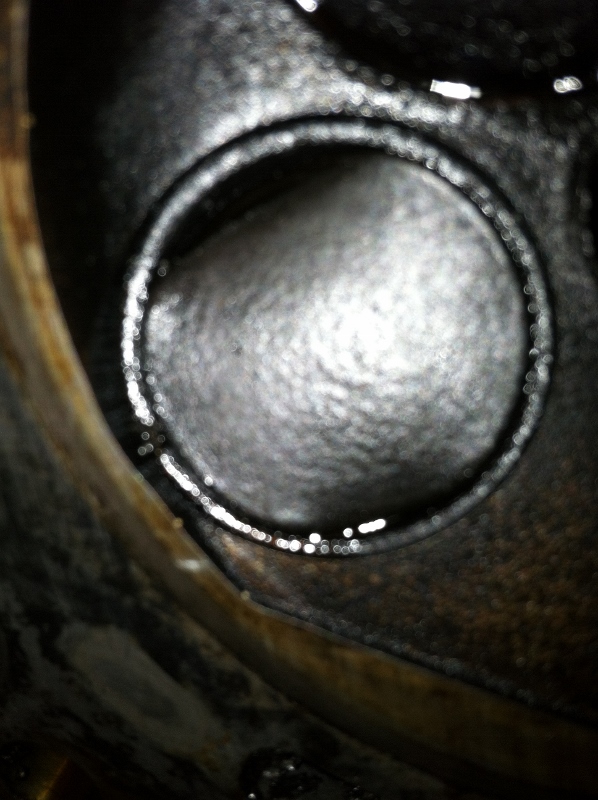

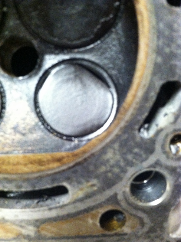

i got the files to load so here is the pics of the burnt valves on 1 and four cyl It was so obvious i didnt think i needed to do a test hahaha
http://www.fixkick.com/bbs2/Suzuki-bbs/g...36_28.jpeg
http://www.fixkick.com/bbs2/Suzuki-bbs/g...37_04.jpeg

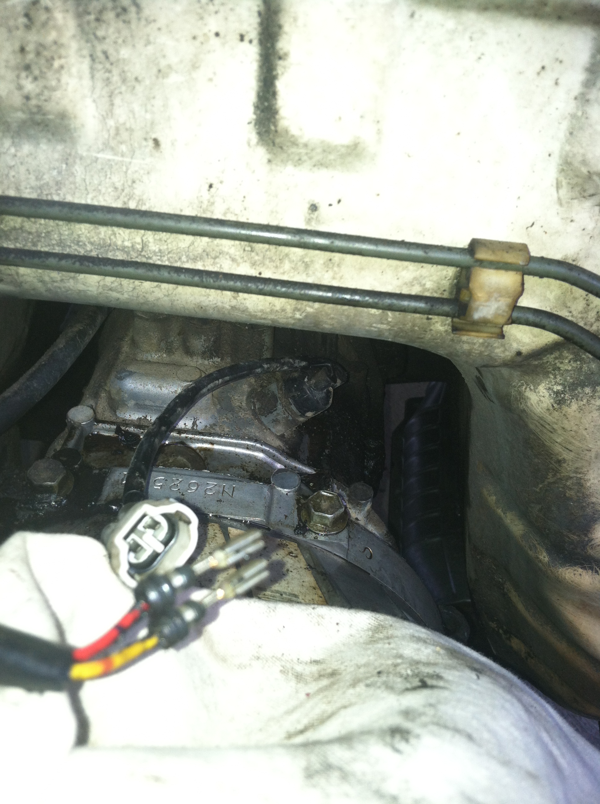

here is another shot of the wires i pulled
http://www.fixkick.com/bbs2/Suzuki-bbs/g...41_29.jpeg
cheers bill
1996 geo tracker cami vin# 2CNBE1867T693XXXX 2wd 5sp
that valve looks kinda sick,
those 2 wires, are non polarized, its a transmission switch (reverse or 4wd or what ever, ) its just a switch so is happy wired backwards.
you're AOK.
