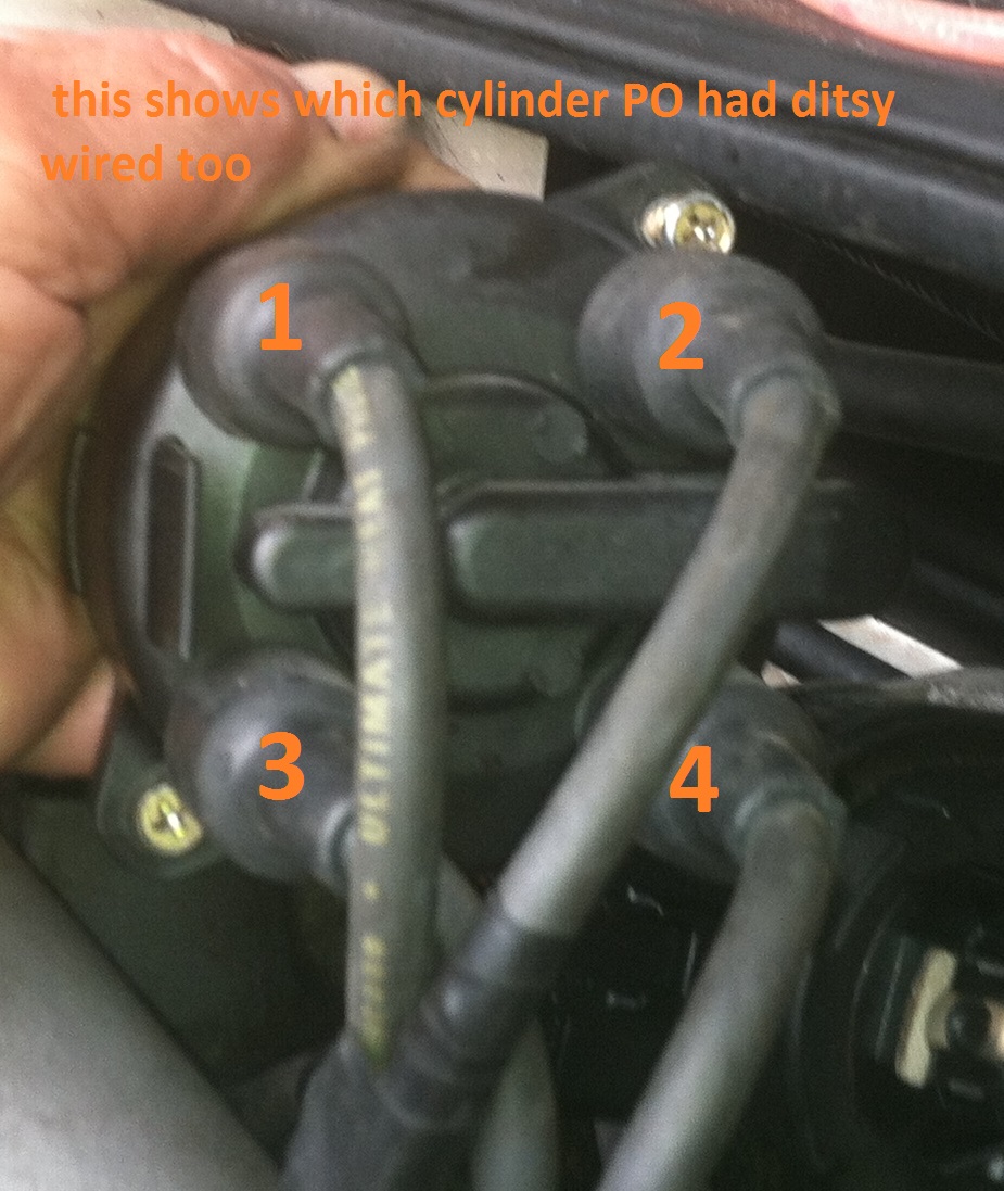

Hi jerry, I think I have found the problem, I wasnt timing the car per se, I was following what the PO had the car running at. I found that the plug wires are at different locations, from what the diagram you sent shows above. So I think my only course of action now is to start from scratch, pull spark wires, get them in the right location and move to valves and crank alignment. this will be kind of crude, but I will show how my wires are coming from the ditsy.
1 2
3 4 myditsy
3 1
4 2 your diagram from above
so it appears that timing is 90 Degrees out or would that be 270 at any rate I
hope you get my drift on the firing order.
also, the spark plugs are gapped crazy big too, so I will reset them for the moment and put plugs on the growing list. I am off to adjust the brakes and try and remove the crank bolt.

the #1 wire can be on any tower pin, and run 100% perfect. ( i see no point it doing so.. but you can. and i have on all dizzy gear cars)

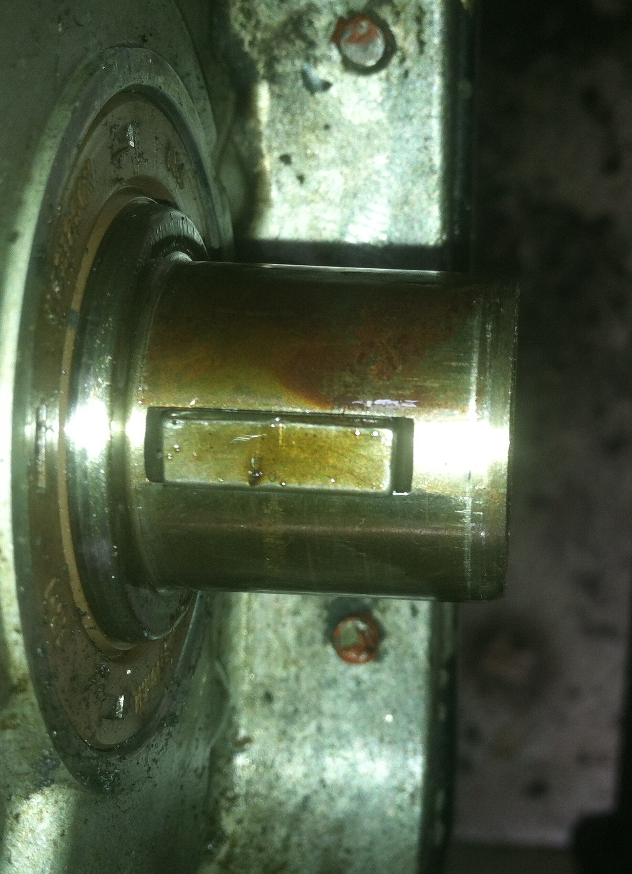

where is you cam key at ?, (in the I slot or the E slot, the photo is not clear (most cameras messup 3D ,LOL ) i cant tell of its air or steel in the hole, in the photo.

cam key is in the E slot E is at 6oclock crank is at 12 oclock

On another note I got the crank bolt off It came off with about 115 foot pounds, The keyway is in excellent shape here is pic

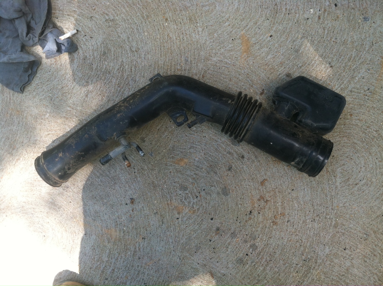

We did find a replacement plenum, though. It is all plastic from maf to where it hits the throttle body, guy said it came off of a 97. here is pic http://www.fixkick.com/bbs2/Suzuki-bbs/g...26_23.jpeg

that is good news. the key looks perfect, and nice back stop boss. it will run forever like that.
