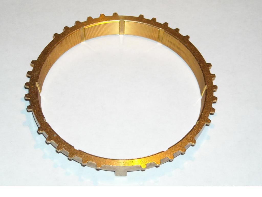

notchly,
that means it slow to get synchros to speed match?
2wd, right 4x2 .
only 2wd trans fits 2wd trans., it has a super long tail shaft,and unique sealing methods.
the new kit is alike $125, new bearings and synchro's
so it shifts ok ,slow?
if yes, then wrong tranny oil, or bad syncrhos. (or the main bearings are so bad the whole countershaft is bouncing.
does, the transmission whine , clutch pedal out, in neutral or dead quiet?. if quite, bad synchro's or oil.
'id not use syn oil in in any old mt, some are too slippery, the stock box was designed for Dino GL4,
think of those cones, in your mind, and that oil film there, how that matters at engagement time.
notchy, up and down. or just down shifted.
by doing tad slower does that help.
3 to 2 is big jump , one reason 2nd wears faster for aggressive down shifters.
when the grooves are gone , you need new ones.
im sliding on new ones here.

Got the Pennzoil synchromesh this weekend.
It is better than with synthetics. I felt improvment for 2nd and 3rd. Now I can down shift in 3rd at about 20mph without grinding which is a relief taking the corners.
I also got the 10mm square drain socket from pep boys. it is $5.80.
