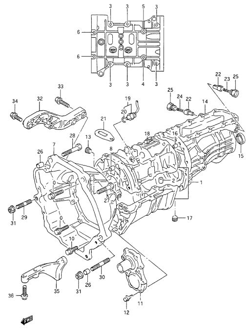

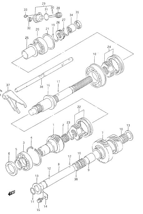

there is 2wd Canadian, version that has simple reduction box for 2wd, behind the, 5speed. never seen one, but its in the parts list.
[Image: 3_26_08_14_11_59_12.jpeg]
here is the funny 2wd box. used up north, the oddity.
