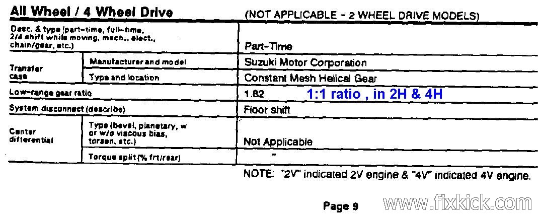

What are my Transfer case ratios , stock,  1.82:1 in 4L
