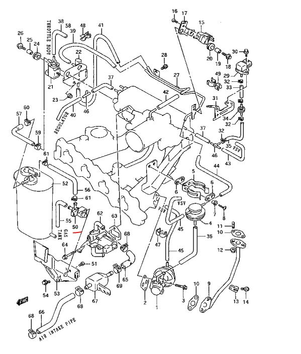

Broke the vacuume hose nipple off my 96 16v tracker vsv (front side,cannister to plenum) anybody know where to find replacement other than salvage yard? thanks once again, I'm an idiot

2 door or 4 door.? car has 4 VSV, 2 for egr, 2 for evap
G16B engine USA. spec cars, have 2 systems ,
they sell them, wont be at Autozoned, sorry.
do you need a real part number.
so the 96 evaL , VSV P/N
I will go fetch it now and post it.
the one next to the CANISTER, and has vent to AIR tube, (goes no where)
that one is
18117-58b30 (named evap purge)
fits both door counts but not EGR parts.
paste this in the search box.
$127
https://www.suzukicarparts.com/parts/199...eid=214820
or is it the other VSV evap , sitting next to the EGR VSV (pair)???
best I can do , lacking photos or exact locations...

Thanks for info, Its the evap purge btw, 2 door w\removable hard top
that is the right part, number, for the vsv that is most close to canister, and purge side,.
bottom right on hood sticker seen here
#50 = 18117-58b30
[Image: 3_29_03_18_6_53_33.jpeg]
in 1996, they did use 2 systems for this page. and with #50 and with out. (96-96 years)what i call GEN3. sub classes GEN3a and gen3b, smog controls, are a pain. with calif and federal versions.
with I call version 2. above
with out is seen here. version 1.
http://fixkick.com/sensors/96-16L-plumb1w.jpg
part ID 21, is EVAP but has different valve, and p/n.

Can you get me part # for #21? received 18117-58B30 but wrong part thanks need one that connects to evap canister thanks

My bad, Its # 21 on left side of engine at front for evap connected with short vac line to plenum sorry
you didnt tell me which VSV? sorry... i tried to tell you there were 2 VSV for evap...so sorry
1996 suzuki or trackers, some CALIFORNIA cars are different, as are CANADA market cars, regardless of factory made.
yes 21 is not 50
and 21 is
same prefix
18117-58B10 (egr is different too)
this vsv site next to the EGR vsv as pair on a bracket.
on some cars, Fed or CALIF. part 50 is not there.
1989 to 1996, lots of parts very different (cal /fed) and the ECU must match them.
