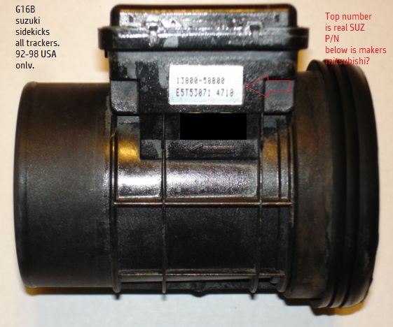

also the maf
on this side is a Mitsubishi sticker, if missing this, then that is clone maf and most are junk.(china imported cloned , knockoff junk) ok found a real OEM MAF photo next.
(if forget if denso or Mitsubishi made. 10 years ago seen)
make sure 12vdc makes it to the MAF pin per pages linked here, or your new MAF WILL BE DEAD. this is the first metered check !!!!

see this sticker here, (rare photos ) it is a REAL SUZUKI maf,
E5xxxxx i think is the Mitsubishi secret numbers,
