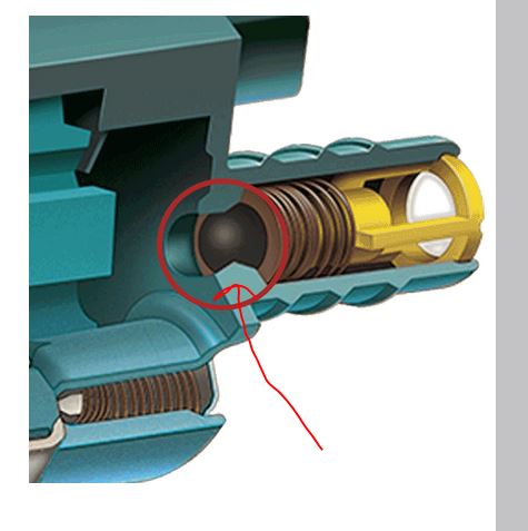

the leak down tests fails with fpr hose (fuel return) pinched right? so that means fpr not it , injectors are bad the check valves leaks or the top pump hose leaks or the camps on it are loose.
if you test the injectors to see if they leak, (not easy) then they are not leaking, or get them clean at witchunter.com.
testing MPI injectors on a car is not easy. (bore scope? to spark hole, wet tip of spark plugs) pools of gas on top the piston crowns. test each cylinder 1 by 1,. with its intake valve open, yah , that works wonders to see the river of fuel to piston top..
if the injectors pass ,. the the check valve leaks, if it does, ignore it.
in fact it will get better in time as used. the brand you got is OK !
[Image: 3_29_01_18_11_23_36.jpeg]

if the pump ball is new and not prefect yet, the only side effect if at all is 1 second more cranking, if at all.
