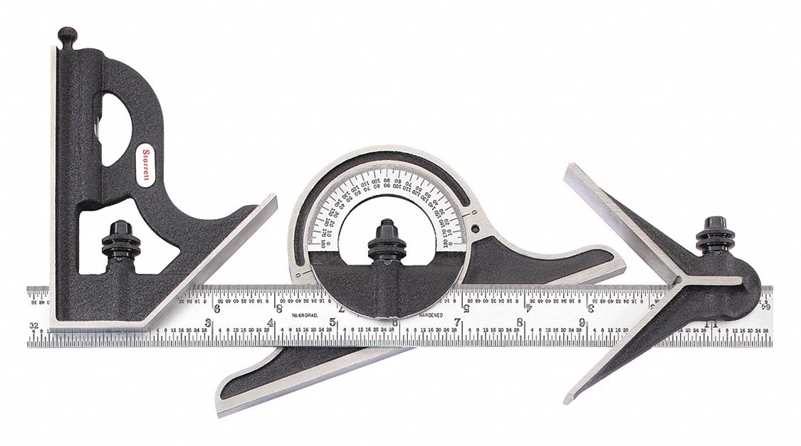

what you do is ,mark the key center ,center of hub, for TDC and then project that out to the spark mark that is TDC. if they align all is good.
one way to do this is what T-square with Y adaptor, and it then finds center from outside inward
use the thing on the right seen here.
https://static.grainger.com/rp/s/is/imag...6Y944_AS01
