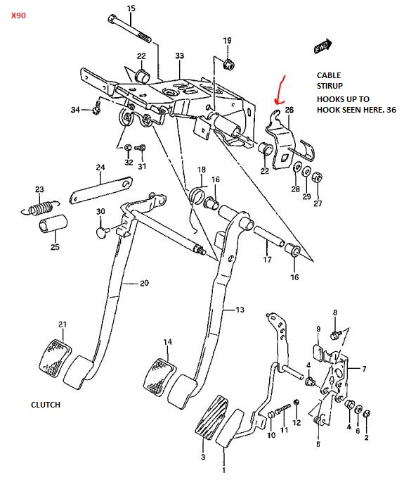

the push bottom end and wiggle top and the stirrup jump free of the top of pedal HOOK.
see part 25 here?

same hook on top. just looked, at the parts drawings.
getting it to put back is harder than unhooking it.

that at the above stated mount, wiggle it and it WILL UNHOOK, at hook 26, see photo?
its putting the hook to sturrip back that is fun, (hard) really seat removed makes all cars easy to fix under dash, 4 bolts and its out.

part 26 is the hook.
[Image: 3_21_04_17_7_29_08.jpeg]
