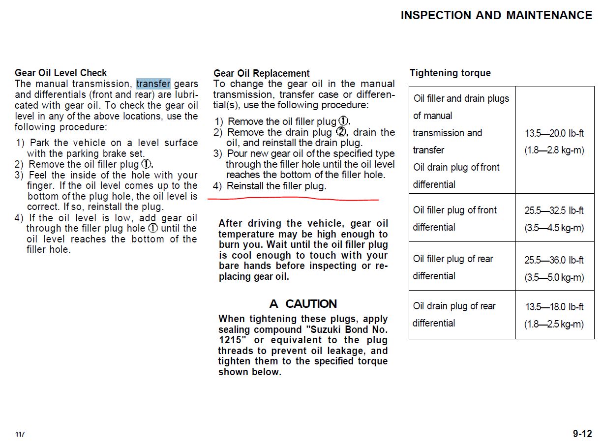

So this procedure is right ? :
I need do open the fill bolt and the drain bolt
on the transfer, let the oil to drain out - put back the drain bolt
and then fill the oil till it will start to drain out from the fill hole...
Made in Japan Suzuki Vitara 1997, 4x4, 16 valves, MPI EFI, 4 speed, Automatic, 1.6L, 5 door, from Israel, VIN: JSAETD01VV1200XXX, market: E54
correct.
drain it, all out (from bottom drain)
put back the bottom plug.
fill to lower edge of fill hole.
off the book page, oper guide, or from fsm.
page
7d- page 17, steps 14 to 18,...
http://www.acksfaq.com/96-FSM-v1-7D-pdf.htm
the 1995 oper guide also covers it in page 9-12
[Image: 3_18_04_16_7_34_43.jpeg]
the drain plug is lowest plug
the fill is on top. the plugs look the same and are both 10mm square drive.
shop manual tells what sealant they used, by loctite, day 1 on the factory, id not use sealant at all, in fact they are pipe threads and are tapered and seal perfectly when fully tight.
