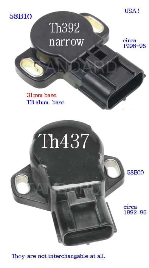

Do you know if a mikuni part number W0133-1645589 TPS sensor will fit a 95, federal 16v tracker, 4x4, manual tranny?

but id need to see what Throttle body is on the car, there are 2 kinds.
one is large (early) and then n the smaller one, introduce here, for OBD2.1996 (not x90)

revised my page and new photo, showing the narrow wide rules..
[Image: MPI-TPS.JPG]

The later 16v NARROW Style housing base, for the TPS, OD is 1.213" 31mm (aluminum side)
ill look up the 2 now. wide and narrow MPI TPS.

ive no idea at ALL what is on your car
but measuring the TB base mount will solve it
as will the tall TPS ,see how tall the old ones were?

my guess is yours TPS is -58B00
but id not go on guess. measure it, photo it.
