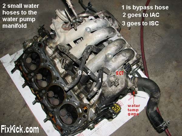

Does somebody have a clue what is this ticking sound that comming from the
rear side of the intake block area? THE SOUND APPEARS ONLY WHEN I PRESS THE THROTTLE
Please see the attached picture - the sound is coming from the area that I
marked with the red arrow...
Maybe I need to take off the part that I marked with the blue square and
clean / fix there sometong ....?
What is the round glass that I marked with the red square ? What I suppose to see there?
Thanks ahead !

the rear side is a EGR VSV, so part level 2 mandate here on EGR. so????
why not use a stethoscope to side of all VSV to see that all are silent. that is a key test, of all bounce, (click) the ECU is rebooting the ECU bad caps deal.
my ecu page is titled, clicking relays or vsv... problem. [/b][/color]
clean / fix there something ....?
Thanks ahead !
i have lots more, for sure on hacked engines, lots and lots. more.
it sure is not stock.
the rear if intake runner, is a mount with 2 screws, 6mm thread to the #4 intake runner.
is it there, and not leaking air. 3 checks, (its dead so simple only 2 checks no 20 like a working system.)
1: the egr gasket main, base is not missing or leaking or the main cracked in half as one guy here said, its ok, sent a photo and its cracked in half sucking air.
2: the egr most close, and stay closed, on this defeated system. it must not leak exhaust to the intake ever again or the idle will misfire.
i have no photos from you of that area that clicks, why?
if it clicks i need to see there.
the blue square is the EGR port tube.
the red square is the mono port drilling port, day1 one in the factory they drillled a 10mm boring in there to the plenum side, and the used a welsh plug here, there is no need to damage that.
if you do the engine will not run, due to massive vacuum leaks do not remove the tube either or the same happens..
