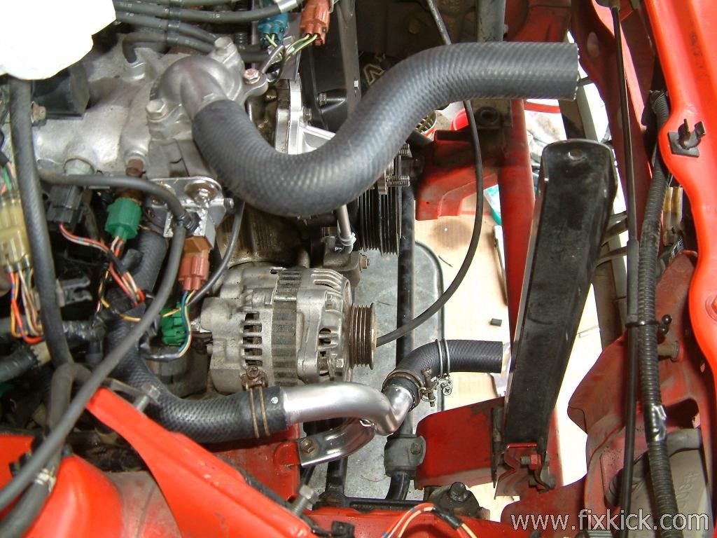

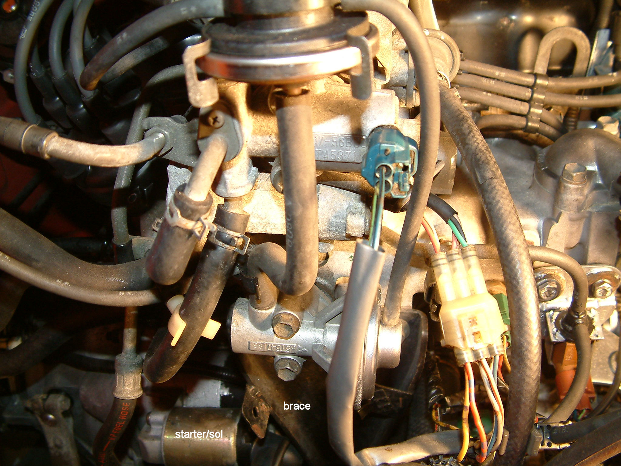

it can only go 3 ways. (plus the wild)
1; out the top, with the intake manifold off. (you just lost all your water coolant AF)
2: out bottom if , Olive Oyl does it. ? super super hard way. (you should get a medal for getting it out, imo.)
3: to the front past the missing Alternator. there is also a brace under the intake the had to come off , if not missing. see all photos. below.
4w:pull engine, nah
5w: pull head with intake in place. ,nah
6w: cut holes in side of fender with plasma cutter. , nah (but is popular on many cars, fwd)
7w: remove all that STUFF on right side (left facing engine) all those many cables , hoses, etc, in the way, never.
8w: remove engine mounts and jack engine up, far as can and gain access.... (like on some Corvettes )
i had to do #3 on all mine...
how this is done depends on the persons size, really, and tools, (extensions to reach top rear bolt.)
this is the 16v head , but the starter is same place. the G16 is used on many suzuki cars not just fwd. but rwd. (swifts is one)
16v
8v (1991 all , same on 89-95 usa)
8v
8v
last is the brace in the way, see part ID 28 next
its not easy, that is for sure, take hard work to get a starter out and back in, INTAKE in place. (pulling intake , you lose your water, id avoid that act)
cheers.

I found alternator off, then pull brace 28 was the easy way.... more steps, but easy, less cussing, just a progression.
down below a ton of crap in the way, if A/T trans, more stuff, cooling lines brakes, etc.
and the cross member is center of engine, and mounts in the way,, i cant even photo that, its such a mess there,
