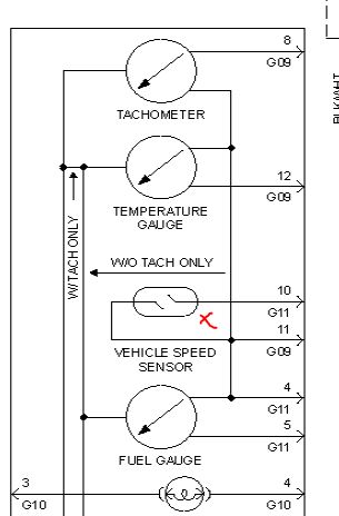

my schematic shows. the rear connector is 13/10/16 pin form factor.
and
this. see your clicker,? VSS2.

your current head,
the speedo needle is dead, just the needle.
the vss2 clicker is working, or the ECU will complain,errors, scan the ECU/PCM see any DTC errors?, no?, then VSS1 and VSS2 are both good. i bet they are.
the odometer works. so no issues there, proves cable works. end to end.
only the needle is broken , the mph clock is DOA, forever.
