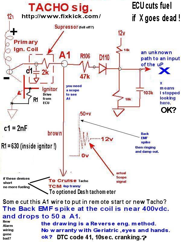

a6 , this is the spark read back pin, it sees the voltage via a voltage devider in the suppressor module, i have have a schematic.
the coil primary goes to 60v or more, during the firing point, (back EMF induction)
this huge spike would blow up any ECU, so the engineer, devised a voltage divider, limiting the size of the signal.
here it is.
the pin number varies by which ECU you have, for 10 long years,
[Image: 3_20_09_16_2_26_25.jpeg]
if you look close the reduction goes 5: 1 more at the top of the 10k before the ECU sees it, The ECU will not like over 5vdc at any time. so.... all inputs are protected.(to a degree)
if you stuff high voltage (even 3 or 6 or 9v or 12v,) onto the base of a NPN transistor, it burns it up. The R1 is there to keep coil OFF , ECU pulled.
the ECU drives the base of the igniter with resistors to prevent damage to the ignition. the current is limited i most cases to under 10 mA, (most hand held batteries can exeed that easy) sorry, but is a fact.
to bench fire my ignitor , I used a 500 ohm resistor to at 5v supply, and can fire the ignitor and coil together.
in simple words, 41 means the tachometer line is dead or weak.
