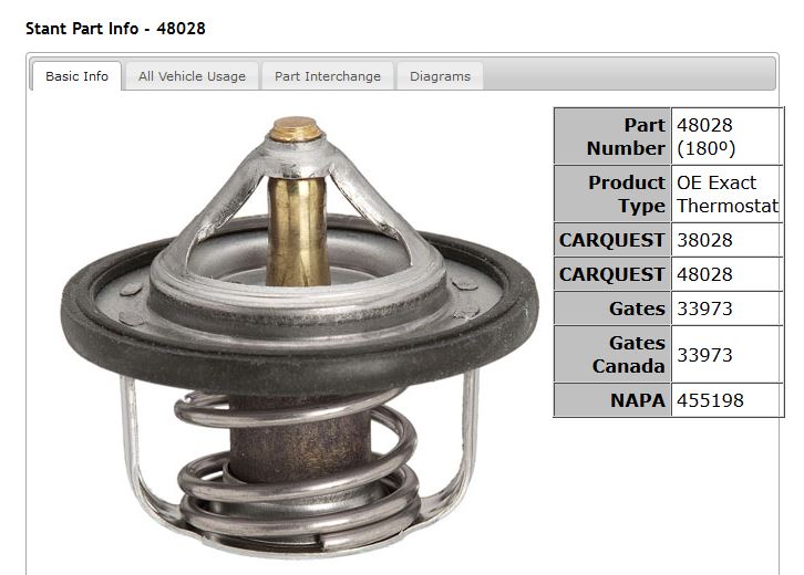

when buying aftermarket thermostats.
they have a list. showing what it fits.
Suzuki uses the same VIN code for engine, in usa, for 8v and 16v (G16a and b) same. and that is a real pain here.
[Image: 3_30_10_15_12_11_58.jpeg]
see that rubber ring,
if missing on 4mm engine, it floats and the engine temperature drifts endlessly, in total chaos..... a bad place to be.
the other bad place to be IS using the above in a j18 or j20 engine as many dumb stores advise.... dead wrong.
the above is a STANT brand, a top brand here.
in better stores i can buy a 192F thermostat. (rockauto has them)
i run the BECK 688, for faster warm ups...

Yes, my thermostat is made in Spain. But when last saturday I open the cap thermostat I saw that thermostat they gave me was wrong, it was a little big, one milimeter more bigger than the old. I measured it with the caliber.. So, I'll given them the chassis number to bring the right one, so I put again the old one and I have to wait, maybe it will come in this week from Santana..
[color=#FF0000] I tested grand ma thermostat.. Al least it open after you warm up the engine after about two minutes or like this, I put my hand next to dash gauge place, and other hand above the cap thermostat where is the big pipe to radiator.. I accelerate a little to get warm up, and I have to remove my down hand because heat, then I felt the heat when the thermostat started to opened..
When I remove the old thermostat and I prssed the spring I tested it as it was a little blocked because I felt some point resistance accompained with a sound as "clac, clac", but after I press the spring repeatedly the sound was over and the spring was hard but flexing best..
And when I start the engine again the gauge temp go up as it was working during all nineteen years e.i. slowly rising, because in the last time it was up very fast, it needed only 50 meters to go up, although the engine was could and was still in 1400 r.p.m..
But about 1000 r.p.m when start in hot continue, anyway, I¡ll wait new thermostat come..
This termostat use rubber O- ring 4.0 mm without gasket as I can see in your warning page figure A as late.. And it has also a bleed valve very small that we must to put in the right way i.e. looking to the radiator as I saw this detail in Rhino Manual.. This is the link, I think you have it too, but just in case..

first off , i glad to help you and your are always welcome here. and no reasons for sorry ever here, its all to easy to have 10 problems with old cars.
some problems even hide others.... (fun no?)
sorry you confused me by posting 16v responses. the 16v has no dash pot. so... is very different EFI too. TBI is yours, 16v is MPI 4 injectors with MAF.
that is correct. the santana engines, in europe run a unique thermostat. but keep that well size in mind, 4mm well lips all need rubber surrounds
my themostat page, hints a this santana BLUES? (old parts) seems they use 1980s parts... for some reasons...
http://www.fixkick.com/buy-parts.html#vit-stat
i only know that above for now... can look up yours. .
IF?
i can look yours up of you photo the body tag next to battery, this has the market codes, and factory codes, etc...
keep in mind that in Europe they have suzuki type engines, type 1,2,3, and more, and then Santana engines.... complex,
we have 2 here, 8v and 16v. super easy to get most parts. if you buy by valve counts (vin is no help here)
1mm bigger STAT
diameter? here , if ours are 1mm larger OD, outside diameter it will not fit into the well pit. per my sections (suz) drawings on page 1 back..
