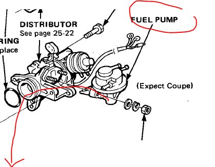

i see your head, (FSM) it has a mech fuel pump on rear of head on a housing,,,, id get a new one. if 28 years old.

i suspect 2 problems., not uncommon on 28 yo cars.
this red line shows the path of red fuel , running to crankcase..... Classic Carb cars. failure mode.

on some cars, (i have one)
the pump leaks, out the pump side. and on to the distributor. and BOOM. (i moved mine to tank area)
but if engine stops fuel stops..... so its not all bad....
the tachometer driven , electric pump works good. (DIY made , and works like EFI), but must crank engine to prime pump and carb....

the pump can be tested for cracked diaphram just like all devices with one.
using the hand vacuum pump... at the fuel output port. and the input port blocked. (1/2 minute standard rule. no leaking down......) do it at 8 inches vacuum,.. not 26.

but why is red oil in my head, i think, I wonder if the fuel pump is dumping, raw fuel to my crankcase as all these cars did back then, just wait and see, they all do.
all diaphragms all crack, that is what they do... in time...
think of the torture it gets. stroking over and over endlessly. running.
this is nothing new. and is always in back of mind... something to be on the alert to , on old carb cars. (some dont have it, but yours does)
