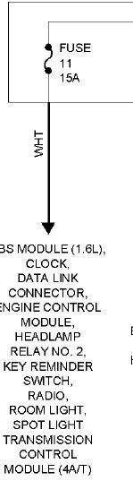

Posts: 6,071
the usa car
has a fuse marked trail, dome , so you can see , if you blow dome, tails are dead (all parking lamps dead)
that is a 15amp fuse in the dash box.
the IG fuse runs ignition and Radio on this car, (stock, ) so if you blow IG fuse , no engine can run,. on 96-98 sport.
i guess the head lamps work and engine runs. so , you did blow fuse.

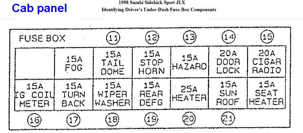

dome/park/tail is cab fuse #11
keep in mind fuses that look good can in fact be bad. use use a voltmeter or ohmmeter to test fuses, live. for volts, or in hand for ohms. (fuses that look bad are always bad)
my guess is you dont know where fuse 11 is, nor its location or it looks ok and is not.
so l show you the fuse box.
next
Posts: 3
Threads: 1
Joined: Aug 2016
Fixkick, thanks for the help guess while sitting upside down and checking fuses I missed the dome/tail fuse and bingo that was the one.. Thanks again for the help, time to go and pick up my tools...
