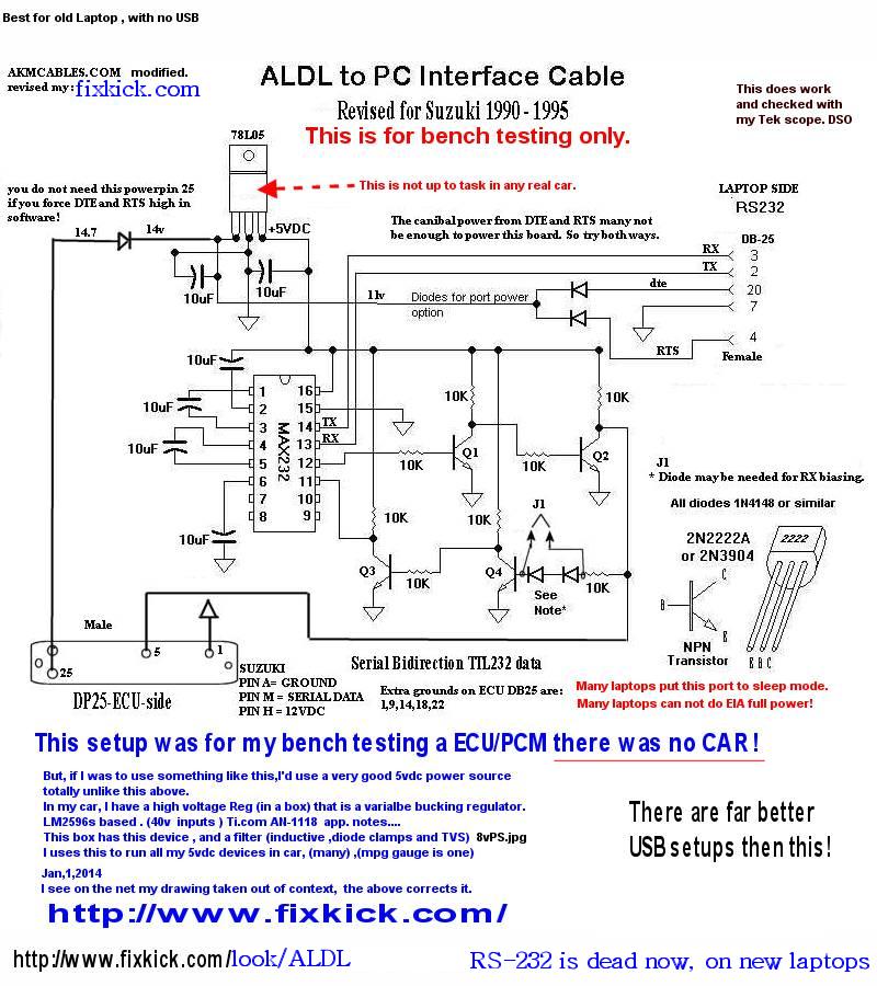

your device is a typical serial. bi-direction interface.
i see you run the LM339 on 12 to 15vdc (vcc is ok at 12) but not pin 14.
that can damage many ECU. on its receive lines.
you need to limit that so the drive (339>ecu p14) signal can not exceed TTL VOH, 4v.
the 339 outputs are open drain.
R2 is the pull up to 12-15v. that is unsafe.
the pull up needs to go to 5v. max.
id not exceed , TTL levels into any ECU (comm ports)
here is the old year 2000?
device that runs our ECU, here.
note how the drive can not exceed 5v. via a 10,000 ohm resistor (this is for very very old laptops. with real R232 ports , now gone byebye)
http://www.fixkick.com/hacking/hacked/ALDL-JTGH1.jpg
most pins on a typical ECU are input protected with large series resistors.
but not all.
and on the COMM lines, i bet not. seen many that are not protected from shorts to battery in car, 12-15v....
its only to be connected to a computer.
using TTL rules.
No even protected from REAL EIA- RS232 (-12 and +12v signal swings as see on main frame computers. and IBM PC from 1981 to about year 2000 when these ports were deleted. These levels were for MODEMS and terminals and printers only then)
and are good,(USB now or wireless)
The reason they (kia) used TTL232 is because they can buy dirt cheap UARTS that work. then they add custom level drivers . all unique to KIA,and all SECRET.

if you read the wiki that is clear as day due to the vast EFI variances and engines used on the PRIDE.
Iran did not rule OBD , until 2012. so that means your car does what ever SAIPA wanted... what ever is the most cheap, even no OBD at all. is possible
or runs secret protocol only factory tools use. (these last to are dead horse to beat. zero changes)
ask here yet, kia forums , tell them , the car is Iran kia Saipa Pride.
my guess is they go Huh?
http://www.kia-forums.com/gtsearch.php?c...7j738329j5
the internet is devoid of older car Saipa facts... a very obscure car..... it seems.
id buy the factory service manual and read the ECU pages..,.. see if there are hints as to what's IN THE BOX. (communications wise).
and one more fact
each tool maker states what market they support EU or USA. (you keep reading USA and EU pages, why?) why look in the wrong country?
The makers of tools all say , it might work in other markets, (is small truth) and don't know, how could they?
because
we can not test all 1billion cars running on earth.
might be 100,000 different ECU/PCM EFI systems, and gas and diesel. in the WILD, (no body knows, it's mind bending complex)
no scan tool on earth does that. not one.
most have never seen or even heard the word SAIPA. ever. much less ponder what's in the box.
good luck in your search.
i tied to get DRB working a 88 Jeep, (French Renix EFI) and failed. first Jeep EFI ever... too...
