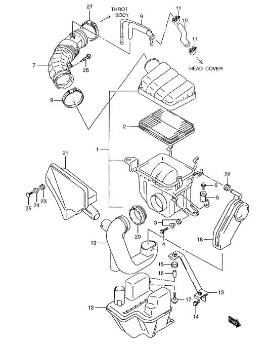

intake (magic) (only a secondary issue to above issues) but counts big time.
the stock intake does many things (the MAF air meter is on the side of the Throttle body, the EGR MAP is on left side if main plenum. box.
the screens must not be removed, they force turblant to to go straight (laminar flows.), allowing the MAF to read right.
(all this is stated on SAE.org engineering documents)
the 2 intake resonators reduce noise and make the air flow , more smother, allowing the MAF to work right.
Sound is pulsing air, and you don';t want pulsing air, at the MAF, so..... all 4 cylinders love to pulse. (unlike say a V12)
the long pipes, on intake create a boost in low end torque, (a fact)
the air cleaner box drains water ingested (cooperatively ), to keep the engine from hyrdalocking and bending the rods!
the front pipe forward of air box,
keeps bugs, dirt, sand and ice out of the system and from packing up the Air filter, in seconds.
The stock system tries to get fresh air to engine, not that filth next to the engine. like most CAI do.
(it's a non trivial design, it not , just for fun, or to waste money on complexity, it just works under all conditions, so you can drive and not worry or have issues, in bad weather, (and bug storms like they have in CALIF and Florida. let it.
Keep in mind all filters, let dirt into the engine!, all do, and the less dirt sucked in , the less that the engine gets, making most CAI setups just a giant , dirt vacuum next to the engine, (a fact)

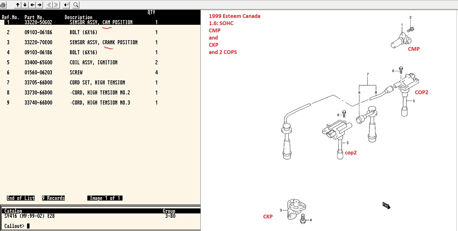

yes the rear left cam has a Cam sensor
the cmp/cas, or as the parts list calls the rear of head, sensor, DLI,
the housing has a base o-ring
pn/ 11162-71c10 $3 at
http://www.suzukicarparts.com/parts/1999...eid=214820
the CMP sensor comes with o-ring
and can be measured, if bad.
https://www.rockauto.com/info/321/213-31...__ra_p.jpg
the housing base o-ring is used on 7 pages of engines, in the catalog
all sidekick G16B and vitara's
the CMP sensor is just a replacement for the distributor, so the sensor is made by others, not suzuki so any o-ring on the sensor is part of that sender and makers. My guess, Denso, or Mitsubishi? sensor.

2: CMP may be bad.
3: not COPS (coil over plugs but the scan tool would have told you they were ok)

I will find both CMP and CMP partnumbers to see what they are and the CKP location
one some engines the CKP is buried behind the fly wheel, J engines. old.
1.6L SOHC single cam with cMP and CKP senors, 1 each.
im looking in a real canada 99 Esteem book now, parts cat. illustrated fully.
the ckp crank sensor is front bottom of engine. shows it pointing UP.
it has 2 COPS, shared cops so if one fails, you loose 2 cylinders, a horrid misfire and stalls there. but it shows P30x DTC errors for that.
the cOP boots fail ($15 parts cheap) the boots fail first. always, and most times not the COP if ever. ever change out boots at full tune up, and win?
it has Electric EGR not vacuum horror system. so no cat is ok. mostly.
The CMP can be bad.
many fail for hot soak, you park a hot engine it soaks and it now will not start, until colder. that is the electrics in the CMP doing that.
we can say in one line your car.
misfires and stalls hot. that simple.
