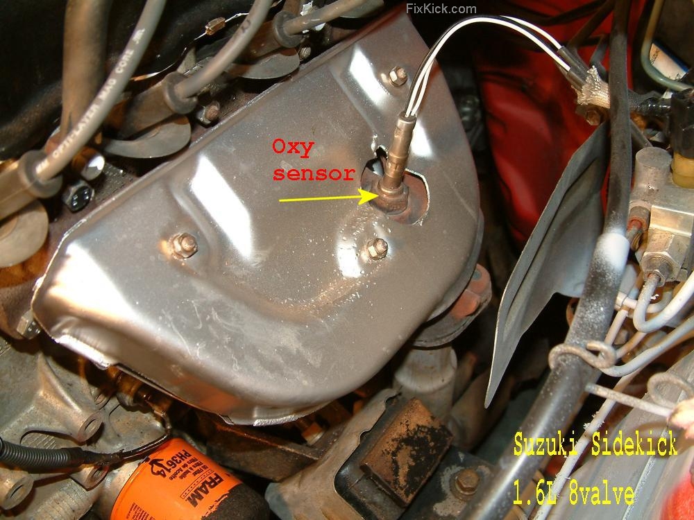

I look at the o2 sensor , there on top of the exhaust manifold and yours is missing. oops.
there was a connector with a harness to the rear.

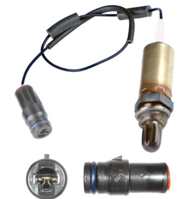

it's just 1 Red wire, to ECU pin A19 The casing of the sensor forms the other connection, ground.
Most 1990s have just one wire, no heater.
I have a schematic here, (with comment flags) see page 3
it's a single RED wire and connnector.
http://www.fixkick.com/ECU/89/1990-scan-...lpages.pdf
the BOSCH pn is 12050
the connector is round, and very unique in the world of suzuki connectors.
[Image: 3_12_12_14_12_34_05.jpeg]
this is 1991 (i dont have 90 photos at all) the harness behind the master brake cylinder hides this connector on 1991.
