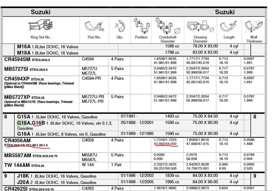

king diameter , 44.000 / 43.983 mm , cold not find a data sheet there.

king CR4056AM
the king catalog (ecat is useless) the PDF is huge 1000 pages
page 474 is it,
they have data sheet I can not find, showing the many sizes.
see the 7 sizes here, std, up to 1.5mm cut
[Image: 3_30_01_19_9_51_59.jpeg]
Id call king and ask for data sheet. CR4056aM If that yours, they have like 4 grades up to burning nitro methane (fuelers)
