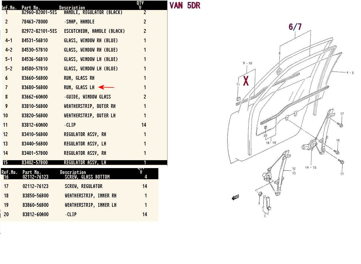

ok here they are.
front door left
PART 7
CALLED A run
AND IS SOLD
SEE BELOW , WHAT IS , AND WHAT IS NOT SOLD.
EASY
http://www.suzukicarparts.com/parts/1995...mCallOut=2
FOR SURE that is my guess, bad RUN.
id have to see it shake to condemn it. (says the guy on a bar stool>?)
its not a problem the shaking,
just annoying, etc.
unless the window n falls down by self, seen that.
they told me part 4 was discontinued long ago.
but found one using Suzuki private dealer network,.
maybe suzuki is making more parts now>>>/?? cant sell cars here, so sell parts. that is good news.

Wow $94 for that? No way. Too expensive for such a small part.

For the left door on my 95 tracker, the crank mechanism would be backwards, but looks to be the same. The crank is actually forward of the bar that runs the window up and down. Perhaps a right side mechanism could be purchased for the left door? Maybe the switched the arrangement over time.
A couple of things when working on the doors. 1. There is a plastic cover that cannot be removed without compromising the seal to the door frame. I used some clear calk to get it to stick again, but the plastic gets stretched and does not go back perfectly. 2. you have to do all work on these doors through small openings in the door panel. Not too easy. But, I was able to get a can of undercoating inside to spray the bottom of the door. It wasn't in too bad of shape, but will not hurt to put some in there. 3. The guide rails on the sides are barely visible. It looked to be difficult if you needed to work on them. It appeared to have a plastic liner inside of them. I should have taken some pics.
