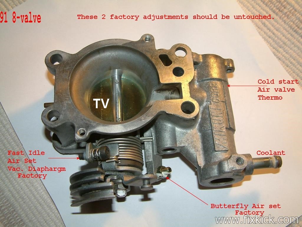

you start the car, did the dash pot, retract 100% you will see an air gap between that DP rod and throttle cam. this means its retracted and not messing up idle, at all, (not touching)
now with the car hot idle, pin the cool ISC air line 100% RPM must fall to like 400rpm or near stall.
if it dont do that , that means there are air leaks (vacuum leaks) and is why the ISC has lost control.
this screw with white paint must never be fiddled or changes, or the ISC will FAIL. (the white paint is the warning, dont touch me)

I adjust the idle by turning the bleed screw on the throttle body. No one has touched the throttle stop screw.
Let me get this straight.....if I adjusted the idle bleed screw on the throttle body the ECU lost control? How do I get the ECU back on track, would I have to replace this? If I replace the ECU what happens to all the adjustments I have made prior? Will that effect the new ECU and will it lose control again?
