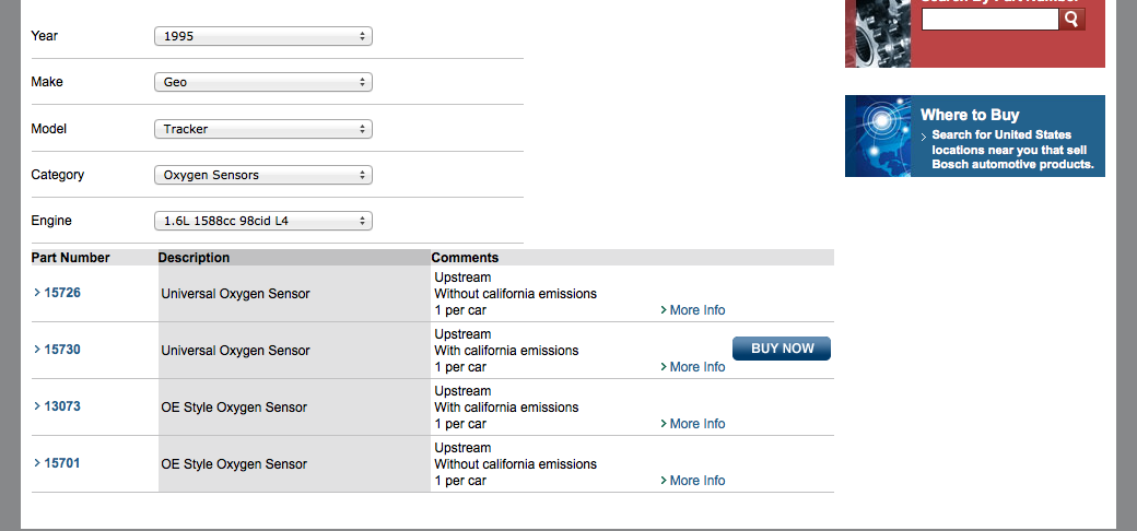

I went to install my bosch 02 sensor on my 95 fed, 4x4, 16v. What I noticed immediately is that the factory installed 02 has 4 wires. However, the replacement Bosch only has three. I'm assuming this is not going to work. I purchased the Bosch 15701. The connector looks the same.

15701 is 3wire, if you look here and click "more info" it shows, a photo of 3 pins.
13073 is 4wire, and has white nylon conn, i now see they have others. 2 more.

all are here, look carefully at each, with the more info.
http://www.boschautoparts.com/VehiclePar...inder.aspx
Yes, bosch is saying you need the 4 wire for ca emissions. In my case, this is not true. I have a fed 4 wire. Here is their page. It's all good, I sent the old one back and have the 4 wire on order. I wonder why a fed vehicle has the 4 wire?
