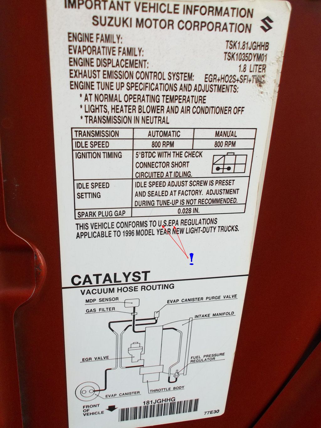

I uploaded your USA TAGS.
its made in JAPAN, and not CAMI
it is for USA delivery.
so the car is OBD2 car. (applicable to 1996 epa regs,means its OBD2 car) << this is how Suzuki states this, and no separate tag, like most cars have.
did you look for the connector above your shins (knees) see the yellow arrow., in post #4?
the OD flashes for 4speed transmission errors, TCM sees errors)
the ECU on later. years, can report that the TCM sees.
your car is a prime example of a build date , for the first 96s ever made ,in beginning of fiscal year 96, July1995. but was build to USA regs for year model 1996.
GOT THIS?
