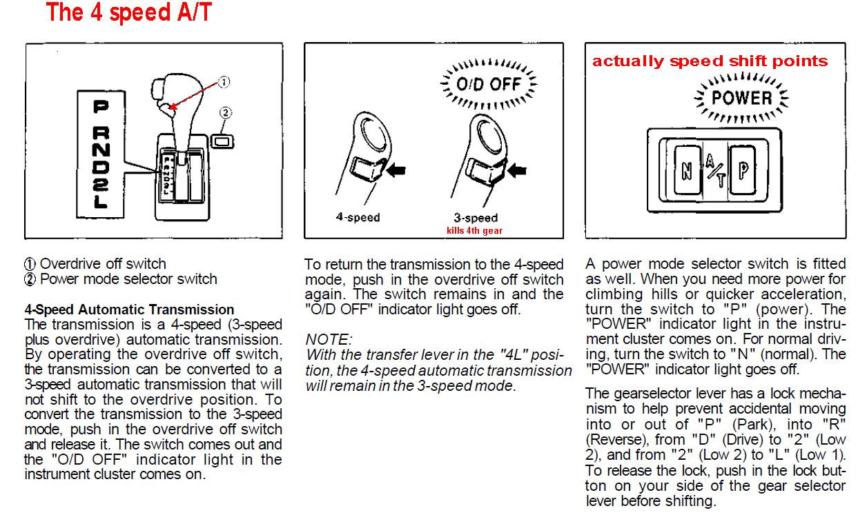

the transmission on your car is my guess 4 speed,with OD lamp and button and P/S button (power sport) made by Aisin of Japan. like this photo?
http://www.fixkick.com/tranny/slush/4sp-selections.jpg
