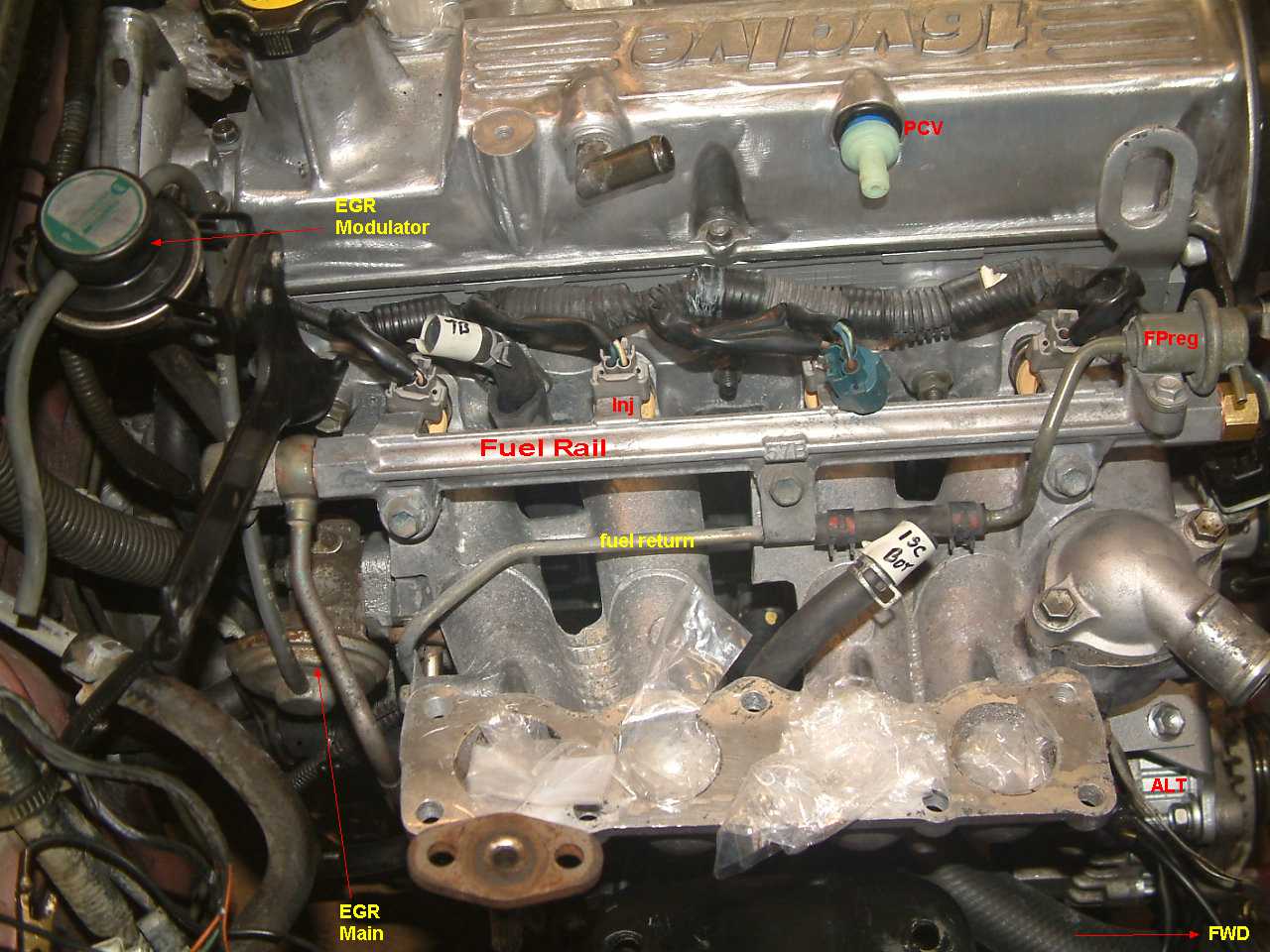

using real fuel pressure gauge , pinch the return line,
on 20 years old that pinch may wreck that 20 year old relic rubber line see at the aft end of FPR
I have nice photo of the FPR here, and that old old line,
[Image: intake-install%20(3).jpg]
