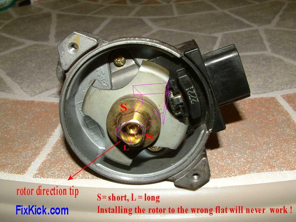

next, is get that dizzy planted correctly. so that the new rotor from Bosch points to #11oclock. (china rotors suck, id never own one, ever, no body needs this pain....)
now take off rotor and dust cover seen in photo above, see that. (after all ive no idea what parts you have , that are not stock)
then with distributor planted correctly show me a photo of your 4 star tone wheel.? as seen below, the dust cover is not optional (rule 10?)
this will tell me , yes Bosch fits(it will) or the china crap rotor IS wrong, 3 don't fit in to 4 at all, 3ways and 4 stars, dig? <hotel hell i call this)
if the rotor is right the star aligns correctly, every time.
if not?, not.
i revised this just for you, its no where else this photo , see the star trip point? and the horror if not?
see this tone wheel, star wheel? this makes the spark, and must not be wrong, if the rotor is china crap, it can be worng 2 ways. and correct 1 way only.
the bosch only fits one way, and means i dont have to tell you all these details of the STAR, see? (but is ok, )
ive seen crap rotors with no steel spring clip on bottom of ROTOR this is JUNK.
why not buy a real rotor. and not fool about using junk parts.?
the rotor dizzy shaft has a long flat. only this flat tells you where the tip goes if hell bent on using crap rotors.
if this is correct, and the star is correct, and crank marke is at TDC #1 and valves closed on #1 and the rotor at 11oclock and the wires laid down like below, then it runs. (and star pointing correctly too.) The star deal is not covered in any books, because they assume, that you buy OE certified parts.
this photo is clear, no way to confuse this....
the wires are layed down like this, only this way
since the rotor turns CW, (clock wise) that star tip, you can see, that the leading edge of that STAR, files the coil.
well not really, it tells the ecu to charge the coil(there), and the ECU releases the coil in 2mS (Dwell), and it fires then, to be exact.
using the wrong rotor, is pure hell.
if you move my arrow i made (my pretend rotor) and move it to the wrong flats, you see why the spark will be hopeless.

now we have a fix , not covered in any book on earth, how to fit up wrong rotors.
and will fire ok , with rotor aligned with any leading edge of any star, after all the star no ecu can know which star is used.
only the trigger point matters, and that the wire routing is correct from cap.
that is why the distributor can be timed 4 ways to 4 cap terms. it's cant tell you did that.
the 2 other flats wrong. causes.
wrong 1, fires way too late
wrong 2, fires way too soon,
this causes the spark to jump inside the cap a huge distance (1/2 inch?), causing the most odd spark effects imaginable. weak and intermittent.

then the distrubutor is now planted wrong, it not really 11oclock and is dead wrong. 2 ways from sunday.
yes, double hotel hell ,
and also means if the rotor is corrected after the pLANT,
then its still 1 way dead wrong

94 , is the #
the hard part is finding the lost TDC , slot damage.
then getting it to hold TDC for the torque application.
the rear if the cog needs to be still flat
and the crank boss it hits,same, or i can slip.
