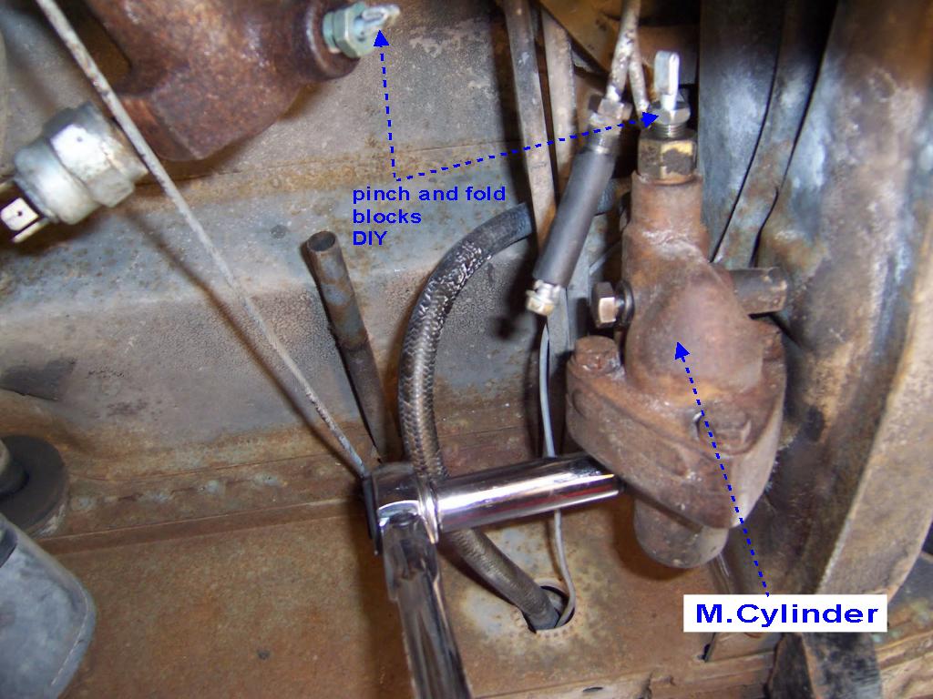

Blocks:
You can use old hard lines bent and pinched closed, to block the MC , 100% to see if it is bad (after bleeding just IT)
You can buy MC port plugs.  if you dont want to make your own.  You can test he MC on the bench before it gets put into the car.
Keep in mind , you can test each half of the MC 1 by 1. (not all at once.)
