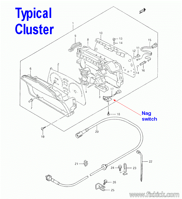

SPEEDO CLUSTER , typical.
Suzuki Vitara SE416
(Sidekick or Tracker)
(1992 & 93 MODEL)
E33 = CAL E03=FED48
MT= MANUAL TRANS
AT= Automatic tranny
ID#
SUZ. P/N
MODEL TYPES
Q
1-1
34100-71E11
SPEEDOMETER ASSY
MT:E3:2WD <-34100-71E61
1
1-2
34100-71E11
SPEEDOMETER ASSY
MT:E3:4WD <-34100-71E01
1
1-3
34100-72E01
SPEEDOMETER ASSY
MT:E33:2WD <-34100-72E61
1
1-4
34100-72E01
SPEEDOMETER ASSY
MT:E33:4WD
1
1-5
34100-71E21
SPEEDOMETER ASSY
AT:E3
1
1-6
34100-72E21
SPEEDOMETER ASSY
AT:E33
1
2-1
34120-71E11
*BODY ASSY, SPEEDOMETER
MT:E3
1
2-2
34120-72E01
MT:E33
1
2-3
34120-71E21
AT:E3
1
2-4
34120-72E21
AT:E33
1
3
34220-66A00
*BODY ASSY, TACHOMETER
1
4
34320-60A10
*BODY ASSY, FUEL METER
1
5
34420-60A10
*BODY ASSY, TEMP METER
1
6
34113-60A10
*GLASS, FRONT
1
7
34145-80200
*COVER, TRIP KNOB
1
8-1
34151-60A31
*CASE, METER
MT:E3
1
8-2
34151-62A11
*CASE, METER
MT:E33
1
8-3
34151-67A50
*CASE, METER
AT:E3
1
8-4
34151-67A60
*CASE, METER
AT:E33
1
9
34950-60A10
*BRACKET, METER
2
10-1
34152-71E00
*PLATE, PRINTED
MT
1
10-2
34152-67A50
*PLATE, PRINTED
AT
1
11
34172-50E10
*SOCKET, BULB
4
12
09471-12092
*BULB (12V, 3.4W)
4
13-1
34175-78900
*SOCKET, BULB
2WD
8
13-2
34175-78900
*SOCKET, BULB
4WD
10
14-1
09471-12055
*BULB (14V, 1.4W)
2WD
8
14-2
09471-12055
*BULB (14V, 1.4W)
4WD
10
15
34165-64A50
*WIRE
AT
1
16
34172-66A00
*SOCKET
AT
2
17
34130-60A30
*SWITCH ASSY, SES CANCEL
E3
1
18
03541-05123
SCREW, SES CANCEL SWITCH
E3
1
19
03541-05203
SCREW, METER
4
20-1
34910-62A20
CABLE ASSY, SPEEDOMETER
MT:2WD
1
20-2
34910-60A41
MT:4WD <-34910-62A10
1
20-3
34910-60A41
AT
1
21
09403-07306
CLAMP, METER CABLE
1
22
09407-18403
CLAMP, METER CABLE
1
23
34926-60A00
CLAMP, METER CABLE
MT
1
24
01550-06163
BOLT
MT
1
25
34926-57B20
CLAMP, METER CABLE
AT
1
26
01550-06103
BOLT
AT
1
