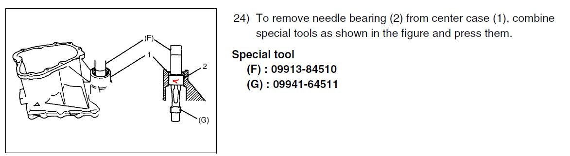

Apparently there are different configurations for the counter shaft. I have not seen anything like part 45 and the adjacent parts...is that the synchro?
The two special tools shown in your diagram are interesting. Looks to me like the lower one has the feet/hooks that would run in the slots I was trying to describe.

Depending upon what you are attempting to do, there may be options (cheats). Looks to me like the main shaft could be removed in either direction. It is also possible to remove the chain without touching the upper chain gear on the main shaft.
special tool G looks like this...
http://www.ebay.co.uk/p/original-suzuki-...7675.l2644
and apparently used in motorcycles.
Scott
they dont spec those tools for size. so who knows./
