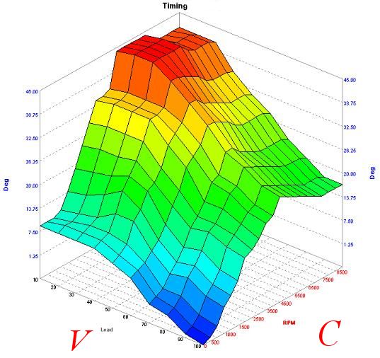

see this.
all you need is in this one clear 3d graphic, this is timing, seen in a much more clear way.
this is the magic curve in all cars today, they burn 20% less fuel doing that, and more power, matching that un-wasted fuel.
what you ask is what happens if you take that left lower point and lower it to zero. (vacuum hose dropped and plugged)
there is only one answer, the low end power will be weak and fuel will wasted.
if you set static too far advanced.?
what happens
see the top RPM advances here (mountain top), you then get them into the illegal zone, ping zone. so now you need , high octane fuel. to do that. (burns slower it does, that fuel)
my lawn more has 3d curve that is pancake, flat line, no dynamic advance at all and sends most the fuel , out the exhaust, but if keeped at a constant speed, this can be tuned, one speed, one load.
Cars are very dynamic bests, driver and hills. so we need a dynamic spark machine,. or power lacks and fuel is wasted.
btw this curves sits on top of static advance.
so if at 10 D. BTDC then add 10 to all numbers on left side of graph.
