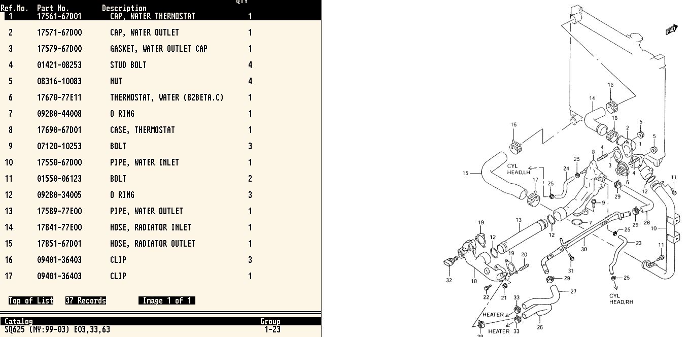

in the above links. there are 2 parts, there, which one is correct IDK, only you can look at the online drawing and pick the 1 of 2 parts seen there, or walk in to GM , lay the part on the counter and say this.? first you need to make sure the PN matches your part, do so carefully. the drawings are very crude. there. sorry
https://www.gmpartsdepartment.com/parts/...ass%20pipe
this is called bypass. pipe. a suspicious. if you look carefully there, there are 3 parts there, 2 , housings, and 1 thermostat, only 1 if stocked, and shows the parts missing , the other 2., do not let also some parts listed as instock both GM and Suzuki are in fact not in stock (bad acts) I MADE THIS LONG AGO. http://fixkick.com/engine/2.5L%202004%20...engine.pdf CHECK OUT MY PAGE 16, ? THE RIGHT (LEFT FACING) ENGINE IS STAT HOUSING, SEE PAGE 22 i GUESS YOU BROKE THE RIGHT HOUSING, STAT HOUSING, right housing from drivers perspective (as is normal way to ID parts , drivers seat) and last my page 41, I show this part 3 times in my PDF. (save it for next time?) the wrong housing goes to the top of the radiator, (oddly) the correct housing does down huge steel pipe and lower RAD fitting. the 2 parts , 2 housings 1 is "chicken lips" rare. (last one made 2003?) here is is the suzuki drawing more clear. and part 1 is it and with better name.
03-06-2019, 10:03 PM
so using the better suzuki drawing
you need part ID 1 seems to me GM calls #1 , as #23 best I can tell. here https://www.gmpartsdepartment.com/parts/...G%20SYSTEM and here https://www.gmpartsdepartment.com/parts/...CallOut=23 walk in to any GM dealer and ask for this part, they have there own network, that can find it in all GM dealers USA wide, no faster way exists, (no 3rd party) Part Number: 91176899 part ID 24 at suz; does this link work,? https://www.suzukicarparts.com/parts/200...eid=214820
