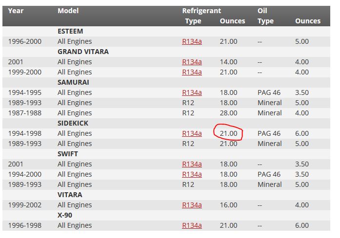

refr: (20oz systems are about average)
http://www.techchoiceparts.com/refrigera...rst#suzuki
except:
so if capacity is 21 oz.
then the compressor makers datasheets will work to calculate the correct oil, type and cc , amount.
