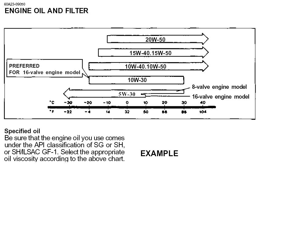

the real question is this, is 16valve, which oil sold, does not do like seen below, back in 1998, are there oils, that still do this bad thing>?
are you willing to bet engine on this guess?
see that 16v notch and warning, bob the oil guy tells you, this is gone now..... but is it? , can anyone say that, for all brands, and dino/syn/blends.>? its GONE ?
my guess? (FWIW) is that in 89-98' the 5w-30 oil , when over 3000 miles old, would not make 30w spec, at 212F, hot, due to shear effects. if truth, many syn oils do not do this, thing, (but some do)
So if some DO shear still, then which ones DON'T?, (ask your friendly oil engineer)
This Suzuki warning is about the CAM. (and 8 extra valves and lobes), my guess is they had cam failures, and the cam has no bearings, its just machined aluminum. and tend be loose after 20 years, and rebuilt heads you dont get good clearances here, just so-so...
the limit here is .0047 " (huge) so if .0046 the head is a good core.
so if all bearing leak bad here, tell me how much oil gets there, and keeps pressure high, past the head oil gallery "orifice plug", 0.050" in diameter, i bet this is the cause of Suzuki engineer worry here. IMO.
try to understand the engineer spec'd. the oil not just on new engines, but for the life of engine... (a whole other matter, if you think about bearing wear, and with really hot oil, and the vast array of bottles SOLD OTC)

the 2 numbers that matter here, are HTHS Viscosity, (the 100C and 150C{302F}) rating. ASTM- D4683. "2.6" is the minimum for 30 grade (the key facts you need hot)
many oils back in 90s did not pass the 4683 test. and that is what i think caused the below warning.... IMO (note that , some 0w-40 pass this spec !)
as seen here.
