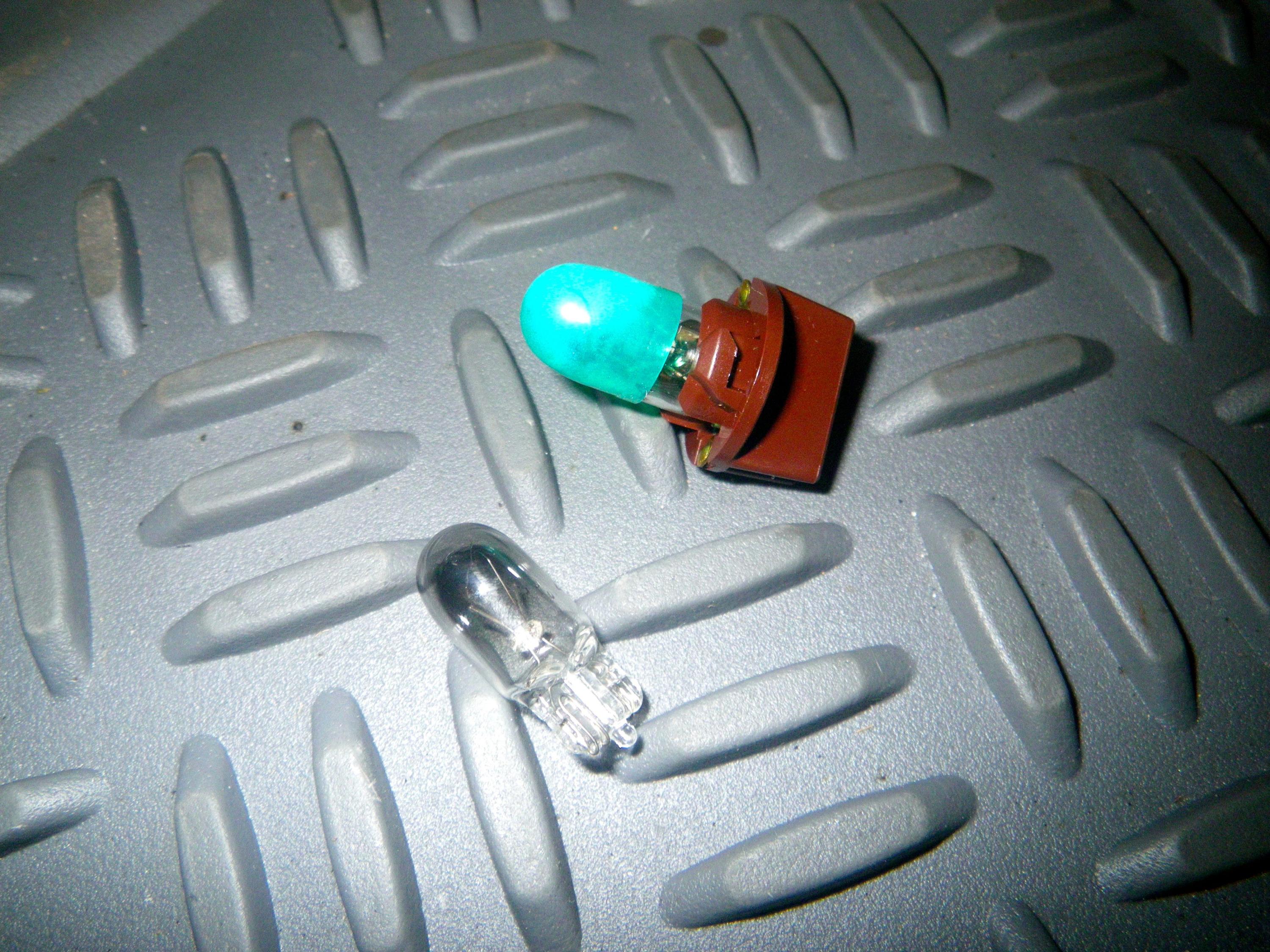

Thank you! I thought those empty holes on slide 12 were missing bulbs. But, I think they are not missing at all. Just the one one each end is burned out. I took them out and they have a little condom on top of them. Must be a light diffuser.
fixkick,
I took the bulbs out and ran up to napa. They said it's a 194 bulb. It has a condom over top of it. He showed me a 74 bulb and it was a little bitty thing. He said it was definitely a 194.
The one bulb I was able to get to via left speaker as you suggested. The right side, I felt up over the climate control hose and did it by feel. Saved me a lot of time not ripping the dash apart.
Here is a pic of the old and new. The new bulbs seems to be working great.
http://www.fixkick.com/bbs2/Suzuki-bbs/g...56_15.jpeg
a 194 is this huge bulb.... the 74 are tiny and the comdoms are tints, some are so old the tint is gone. (green or blue tint)

the correct lamp is
http://www.bulbtown.com/74_MINIATURE_BUL...E_p/74.htm
the 194 is almost 4 watts. and will melt the bases, easy. and is .15 " larger in diameter.
id not use any 194 in confined space. like this.
but if you can fit LED there. sure. but many dont fit. the holder is very limited.
