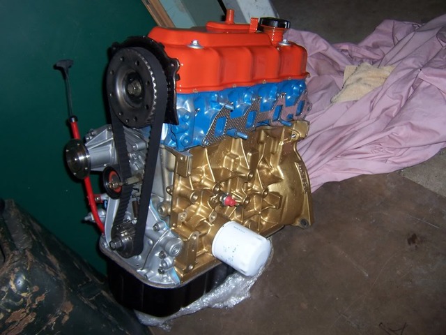

like this, leaks are more easy to find
clean and cover off.
8v example has diffr. VC
[Image: 3_10_01_16_11_48_55.jpeg]
the IR dye kits save time. allowing leaks to be found and huge mess.
hard part is the crank pulley needs to be removed, to do this.
one Saturday off,
back on next
the pulley on ours. has 6? m6 bolts, on the inner rim that come off
with none standard size head, not ISO size, our are 8mm heads, IIRC not 10hex.
some are replaced, with m6 allens. due to queer headed bolts not sold in stores ,but allen are easy, 18 ft/lbs torque.
this gets the pulley of most easy and then cover.
note damage to cover. loose bad belt.
[Image: no-brainer1w.jpg]
if you look close
if the front VC gasket leaks
oil runs , down front of engine, ,easy as , eating apple pie....
