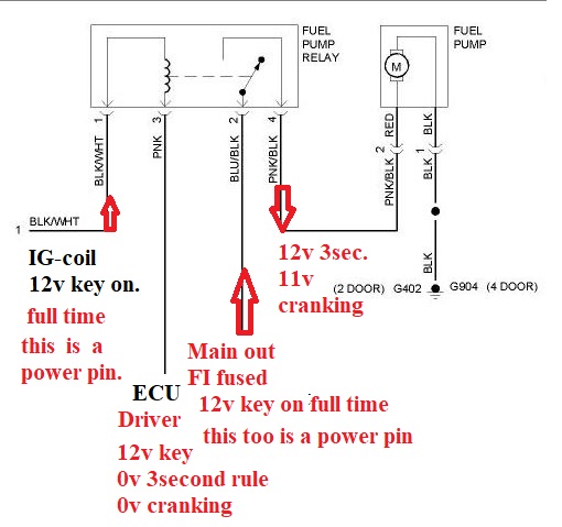

the 4 pins are here.
http://www.fixkick.com/ECU/1996/EFI2.jpg
blk/wht = IG-coil fuse 12vdc, all the time. key on, power.
pink- ecu control line, 12vd key on, and 0v for 3seconds key just turned on and 0v cranking it relay energizes , CLICK
blu/blk= main relay out, 12vdc keyon, all the time key on, if not ECU goes dead. this is FI fuse. if 0v. FI blew, or main relay bad.
pink-bk - runs the pump that is all it does and gets its power from main out. 12vdc.
http://www.fixkick.com/ECU/1996/EFI1.jpg

blk/wht = 12vdc keyon, full time key on,IG-coil line it is. (power pin)
pink- 0v or 12v are only valid here, never 5v ever. if you see 5v (4.64 = 5v) then below is wrong volts.
blu/blk= 12vdc key on, or for 3second or full time key on, and cranked. if you read 5vdc here the pump is short. (this is power pin)_
pink-blk = pump wire, 0v key off , then 12vdc (11v is common) key on for 3 seconds, then falls to 0v, but not if cranked if cranked 12vdc (11 or as slow as 10v cranked)
i can get by just knowing 4 voltages above, key on 3 second long time. just at prime time, what do you read for 3 seconds.
those 4 voltages are prime data.
if the pump shorts (or near) the main power relay output overloads. (pump shorts or the wires to it short)
a bad shorted pump
can in fact cause main to overload and not blow fuse (hint a nice nasty 14amp short)
and the ECU goes nuts (chatters relays) ecu goes dead, 5vdc will never run any ECU made ever.
first test the 2 power pins, seen here, for 10v to 12vdc, (10 cranked ,12v key on)
ok? if test 1 fails the pump is shorted, if the battery reads 10v cranked.
the ECU goes nuts below 10, ,9v is my guess,

if pump volts is weak. (5v?)
check pin 2 above, if that is weak too (5v) and same voltage, weak, the PUMP is shorted or wires to it are.
The driver pin 3 is
0v key off
the same pin goes to 0v key on and sustains for 3seconds then goes to 12vdc after 3 second timer expires.(inside ECU)
if you crank the engine, pin 3 goes to 0v full time cranking, so the engine can inject full.
at no time must power pins drop below 10v. ( and there are surely lots of ways to cause this, huge, and ask if true)
battery cranking voltage is near that, 10v to 11, if not fix bad power first.

Key on Blue black 12.45 turning starter 11.01 (GOOD)
Key on Black white 12.21: turning starter10.7 (GOOD)
Key on Pink 12.07 key on never changes: turning starter 10.7 (dead)
Pink black 0v key on, let off, or start 0v
(if Pink is dead, so will be pink/blk so will be pump dead. the above PINK not keying the relay means, ECU is failing. only why remains.
The ECU is failing. ,

until you check its wiring for damage.
and check power pins. (power and ground) power is12v ground is 0vdc.
and CEL lamp actions.
and scan it. never skip this critical step.,. if the ECU can talk it tells you things are wrong, listen to it. (TPS errors DTC )?
and TPS voltage on pin 3 seen here.
http://www.fixkick.com/IDLE-AIR/dutycycl...ml#16vduty
pin 3 is 1vdc. key on, not near 4v or 5.
1volt means throttle angle is zero .
pin 1 TPS, if that wire breaks, the ECU sees that as endless, unflood mode and injection stops and even the pump goes off line. but injections END NOW.
Quote:I took off very quickly from a stop. Car stalled. No lights Cel or otherwise.
(i edited DEL to CEL) sure CEL dead, the fuse blue, ecu is now dead.
Quote:Checked fuses. IG-coil fuse was blown.
Relays chattering.(that symptoms means ECU sees power feed overloaded in fact voltage power is below 9vdc. bad.
Quote: Replaced fuse.
Fuel pump would not energize.
I ran a switched and fused wire from battery+ to pink+ black wire to get me home (way out in the woods off road )
you hot wired pin 4 on FP relay
will if that action touched pin 3, the ECU is blown up, Q106 is not blown the kingdom come. easy as eating cherry pie, hot wiring the relay,
the battery has 500 amps on tap, so can blow .1amp transistor , 5000 times over. BOOM silicon is now carbon and air.
id test the pump FP relay removed, hot wire the pump and measure its current, if over 4 amps, the pump is bad and was the day one failure cause.
and blew the fuse.
hot wire the pump very carefully even pull the ECU connectors first, to protect the ECU. (all connectors on this car are lever locked, do not force connectors)
