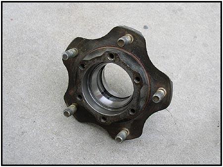

ouch that took over 10tons of force.

Suzuki # 43421-60a00 is the correct part. (same part left and right) same part 2wd/4wd/2door and 4door. {no ABS yet} (lucky you, and did not say)
$188 at suzuki now. (I do not have the GM partnumbers now)

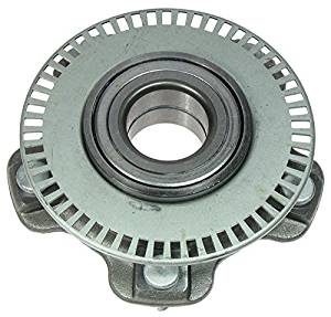

advanced Auto shows AW413, then says may not fit. not only that those parts are NOS< new old stock, ACDelco stopped making this part.
Im in the ACdelco master catalog, there is no such parts, FW at all.
they also made FW252 and 253s, for susuzu too, for some years, no idea the match up lacking old catalogs but they did, (DID)
ACdelco now uses new partnumber( yes, more madeness)
If i look in the book with due care , i learned that the hubs ended before 2001, both GM(geo) and sidekicks Suzuki, so there is no tracking this, lacking old books from them. (I dont have GM)
FW252 was the match I think,... back when. 253's for ABS.
