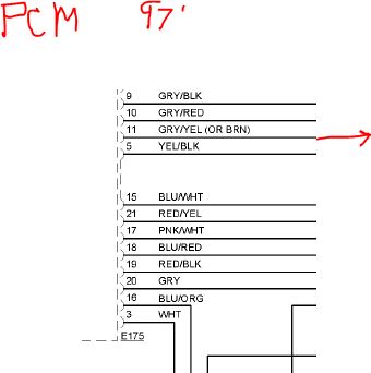

the coolant sensor has 2 pins gray-yell is ground 0vdc.
the other pin is pulled up to the ECU internal 4.7v supply
my guess s the Red-yell wire is at 4.7 (4.75 to 5.25v is spec on your good supply but how ever
the ground is open on the ECT and IAT.
That ground is called ECU super quite ground. and is just a buss bar in the ecu to real ground/
so if i knew what color wire that was.
and the ECU partnumber, well, this gets more easy.
must be 5speed manual transmission
with matching ECU.
the 97 that ground wire can be brown on some markets.

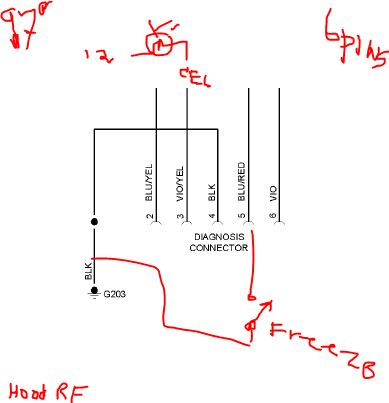

you found the under hood DLC, was originally behind the right front head light shell.
seen here.
6 pins, jump 4 to 5 to freeze timing, to set it to spec. with a timing light.
http://www.fixkick.com/IGN_timing/IGN-FREEZE.HTML
let me look carefully
http://www.fixkick.com/CEL/DLC/DiagJump.html
here is what your 6 pin does.
i horsed it up.
off the 97 schematic page
[Image: 3_03_12_15_6_39_34.jpeg]
the DLC1 (OBD2) is above right knee in all USA 97 sidekicks and trackers.

in my first post pin 11 ECU wire is cut, for sure. at either end or the harness.
that ecu pin 11 gray yellow runs a huge long daisy chain, and as such can be cut, in every place it stops
ECT
IAT
TPS
Fuel tank pressure sensor (EVAP diag)
EGR map sensor
both 02 heaters
all or some can be dead, depends on where the wire is cut, and is.
really one of the most important wires on the car (EFI)
