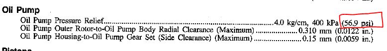

Stock the pressure was 70 psi it has always been like that before I've even touched it. Original Engine had done 275000 kms no problems with oil filters I use ryco filters burns no oil all aftermarket bearings now bought it how it is it could of been changed but everything else in engine was stock all the pressure reg and pump was all checked and turned out all ok
#18
the pressure reg in the pump opens wide at 55, on the button.
the car is old, many cars, this old and owners, have never seen a real stock pump or one that works right. a fact.
old pumps this pressure relief is packed in crap inside and stuck closed,(luck of draw)
then others (vast) buy clone pumps, many made in china, and some so thick the front cog hits. or so poorly cloned, the cloner, forgets, gee the regulator is documented.

[Image: 3_20_03_16_9_07_31.jpeg]
if it never goes over 70psi , at any rpm, id bet the gauge, is just a toy guage , as most are. and is really 57psi,,,,,
