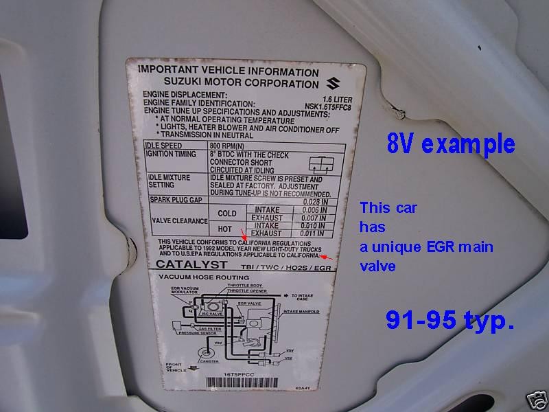

ok , is this a USA federal side kick, or california or canada?

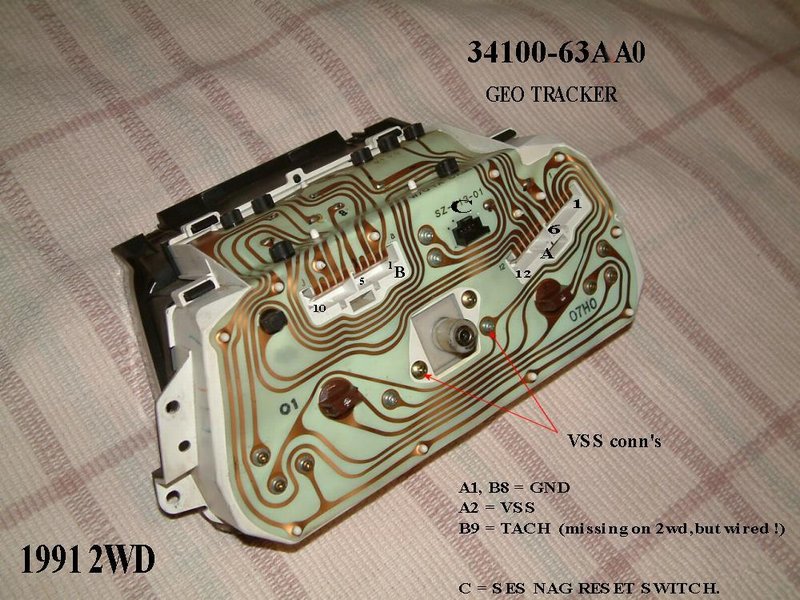

all federal sidekicks have the NAG switch, i remove all mine, they are a pita. if something serious happens. a distraction big time.
the maf unplugged dumps all ECU to LIMPHOME mode, that is really bad, runs rich , and retarded timing and burns up a good CAT as a side show. or melts it. a worse side show.
the hood sticker, is first on all USA cars, open hood, see that white EPA sticker there, vacuum map and spark plug gaps and etc.
that has Compliance text at the bottom see that, are the words California there? if NOT it is a FEDERAL car if car was bought here.

see mpi nag switch photo here.
http://www.fixkick.com/CEL/NAG-Lamp.html
i have all locations documented.
since07
i unplug the NAG here
http://www.fixkick.com/sensors/speedo/im...12WDMT.jpg
once that is out, we can concentrate on the ECU.

yes, canada cars, have 4 flavor, back when, (changed in 1998)
1: real Canada cars, real USA, cars, and gray market. only that hood sticker shows what the truth is, of what it really easy (market wise, and what parts fit car) NO REAL CANADA CAR ever has a nAG switch ,its only cars subject to USA EPA LAWS< period. the sticker tells what you have, read it, it wont lie.

i sure wish i knew what was on that hood sticker, sure do. (US EPA, it says ,or Canada?)
this is the first thing i do, on call cars, see what i have, then look at engine, still stock, then wiring, hacked?
non of this i can do here, im blind.
here is a canada engine bay set of tags. note the extreme difference to USA cars.
totally unique, as one would expect from totally sovereign nation.
http://www.fixkick.com/specs/Body-TAGS/i...NADA98.jpg
see that oak leaf
see those words, applicable CANADA federal, motor veh, safety, bla bla, (bingo , canada real car, and parts.) and its OWN ECU.
add your hood sticker to our gallery, would love to have it, nobody but one now, has.

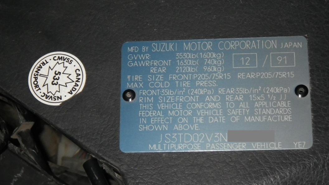

Posts: 7
Threads: 2
Joined: Sep 2014
I found another MAF sensor: I tried it but still doing the same even if it seems to run a bit better (I remove the air box to save time switching the sensors: with my original one, passing my hand in front of the intake/sensor had the engine to almost stall, which does not happen with the borrowed sensor)
ECU looks good, no visual damage, but I will try tonight or this week-end with another one I found
ECU does not seem dead but the fact that that it does not give code when CEL is on is very strange strange
I'll get pictures too - it is a Canada model, I have the maple leaf sticker (it's not a oak) - and put them on my gallery
more to come later on tonight or tomorrow
thanks for the help,

nice of you to add the photos. we have no photos of canada stickers (one for 98, first canada oBD2 car)
good there is no nag, there are non usa countries with NAG features, its a USA EPA brain child, only, and is USELESS to progress. for sure with flakey ECU in USA.

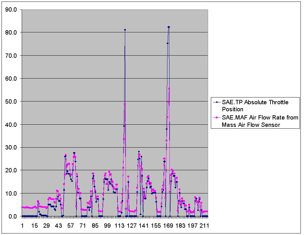

better , ? use my maf page and any dirty cheap volt meter ever made. any Vmeter works. here
here is the page
see fast rule test here. all this is very very simple testing of the maf. (even a dirt cheap flow bench)
http://www.fixkick.com/sensors/92-95MAF/...sting.html
some of my tests, are on EXPENDABLE MAFs, to prove dynamic range only. (im showing how high i can get the output with no engine,)
In a real car, you just drive and watch the scan tool and MAF on display,
like this
http://www.fixkick.com/my96-16v/MAF-TPS.JPG
point 3
the ECU can not tell you if a MAF is weak, only DEAD, or stuck high.
what you experience is low power wide open throttle.

and finally, here is a picture of the Canadian tag, with the maple leaf
I hope to find soon! really miss driving it!! thanks
|Sidekick 92, 4 dr, 5sp, 16v, over 200,000KM, Canada
Posts: 6,091
09-14-2014, 12:42 AM
(This post was last modified: 09-14-2014, 12:58 AM by fixkick.)
OMG, nice photo THANKS!!! very much, love non uSA tags !! a real market 28 car, great and early too...
