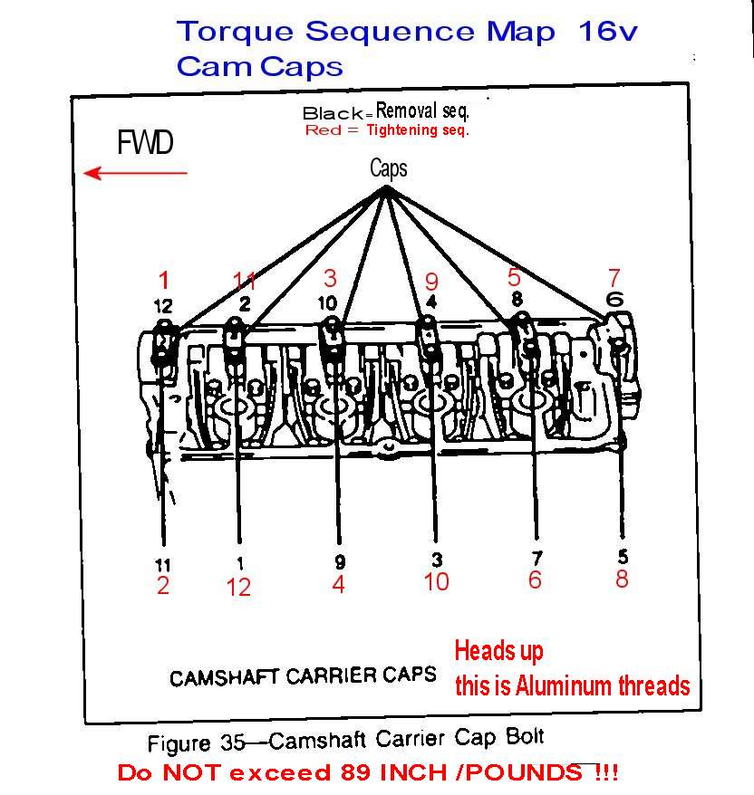

in thing the torque is 88 INCH lbs and that inside RTV is very thin , like .001" under torque, it should not leak.

http://www.fixkick.com/specs/16v-cam-cap-seq1w.jpg

pdf page 23, drawing 47 zone A
the whole thing always works as you did. zone a is the rocker shaft, leak prevention.
