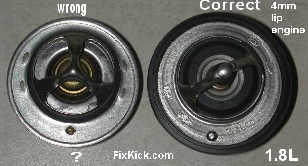

ECT scans? 170to 230F? 40degrees swing. seems excessive to me. That 170 is bad, its too close to ecu , warmup/hot normal spec.
uses the thermostat that has a rubber ring that is 5mm thick (vert) and fits around the STAT and in to the 4mm ring in the base housing pit.
if not, it floats and goes quite crazy. it will surge.
my car runs 195 like a flat line.
yes, the dash gage is slow taking 5min to settle ,its a snail.
yes, im packing Xmas stuff in attic now.....and is cold. 17f this am.
make sure STAT is wax down, bleed front, (uphill) and rubber ring intact.
yours must look like stat on the right.

I will get a new rubber ring for the thermostat and replace it and make sure it is facing the correct way (I am pretty sure it is). When I bought the last thermostat the parts guy wanted to sell me a paper gasket. I knew better so I reused the rubber one. I see they offer 2 thermostats a 180 and a 195, i got the 180.

yes the old 92 has both types , 92 is transition year. paper to plastic is my lil joke...
the old one must be good or it would leak. ring gasket.
must be too cold out,or fan clutch stuck on,
im not sure but below 10F , maybe cardboard, added to front of radiator.... the guys in Montana do that all time, even mack trucks, hell the new macks have built in front variable grill louvers
50% blocking.
