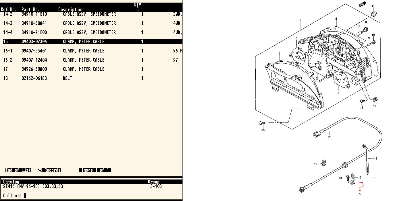

What is the best way to re-install the rubber grommet that goes thru the firewall? Is it OK to slice thru it and spread it apart so the cable sheathing can be pushed into it prior to install? Also, I broke the 2 in white plastic clamping device that holds the cable tight onto the firewall. What is the best way to replace it so my cable is secured and can't move around? Are you aware of someplace to find a used instrument cluster should I need to replace mine. Can I rebuild mine? I'm not having any luck finding one online I've tried eBay and amazon. Again, thank you ! so much ! for all your help. Regards, Russ

the fire wall clamp suz, number is. here?
