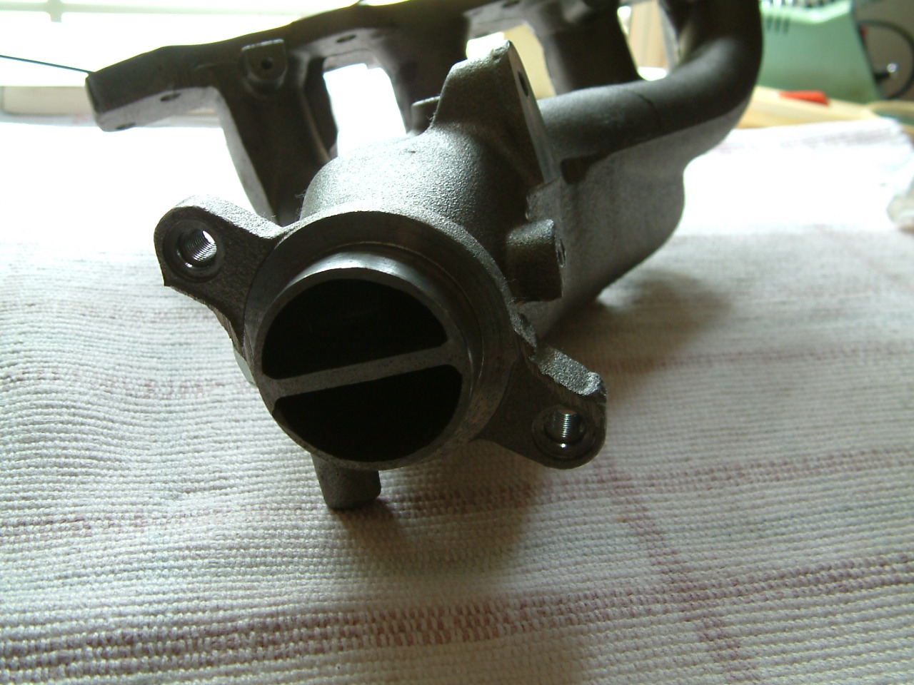

I'd put on after market headers if not living in CALIF. or states that run CALIF smog rules. NY is one that does i think?????? IIRC?
In calif. they do a visual ,and hark, omg a header, is this header on the EO list? they say and look, engineering order list.
that means the calif certified aftermarket list,
but here is some nice headers. that would not leak ever.
i like them all but the Thorely has a poor EGR port, (can change at drop of hat , any time in future)
i think Calmini wins the toss... in most cases.
but in every case , welding fitting can be required.
http://www.fixkick.com/buy-parts.html#misc-mans
stock man is
14111-58BV0
$338 at suzuki
the donut gasket must not leak.
